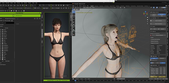

I find this new question,when I build rigify. The mouth is oppen, and head look up, I can make head back with make all controller rotation to zero, but the oppen mouth I can’t make it back

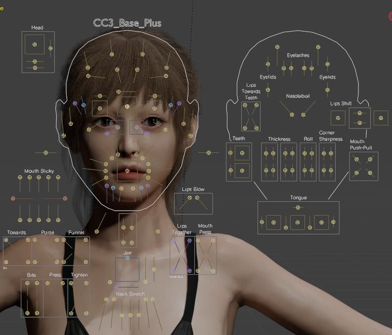

The mouth is open but the Jaw control is at rest. Do any of the expression controls on the rig actually work?

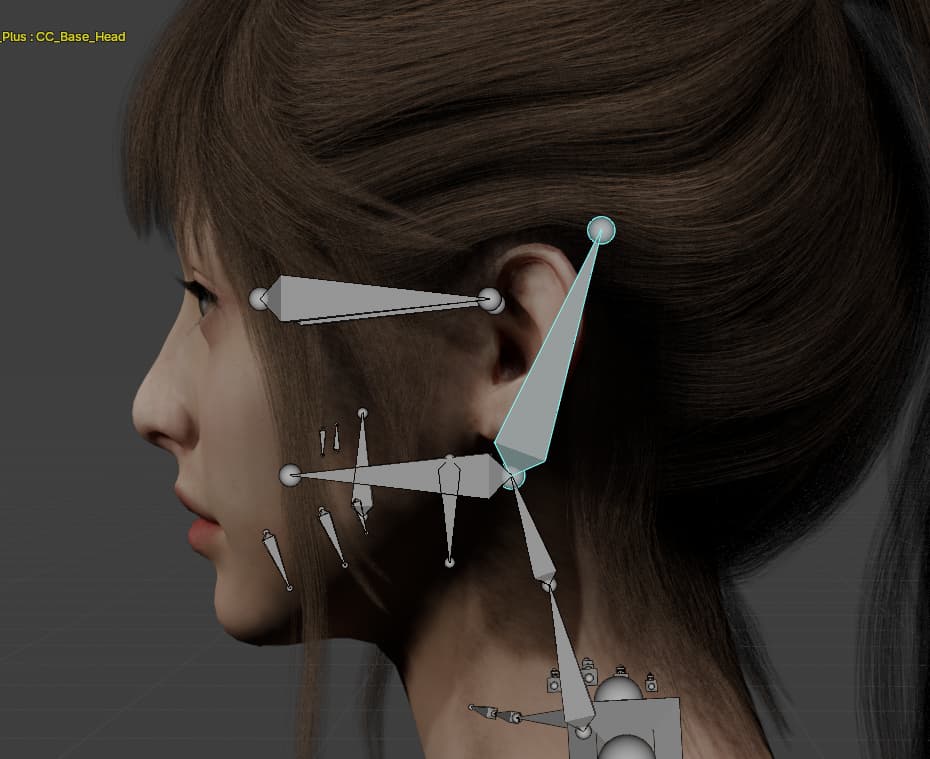

That’s interesting. The head bone on your character is at an angle (It should be pointing straight up)
That angle is propagating through the expression bones and causing a miscalculation in the expression data for the jaw. Not sure if it’s CC5 or the Rigify process generating the wrong data, or maybe both.

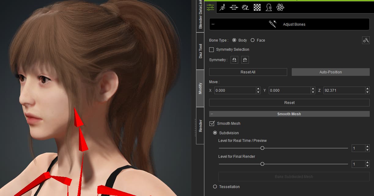

You can fix that quite easily by going into Modify > Adjust Bones → Auto Position:
And that will realign all the bones correctly and it should Rigify correctly after that:

“fix that quite easily by going into Modify > Adjust Bones → Auto Position” will do, thank you.
