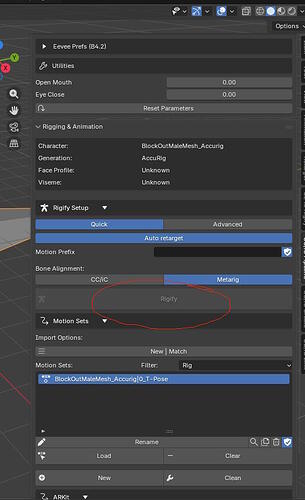

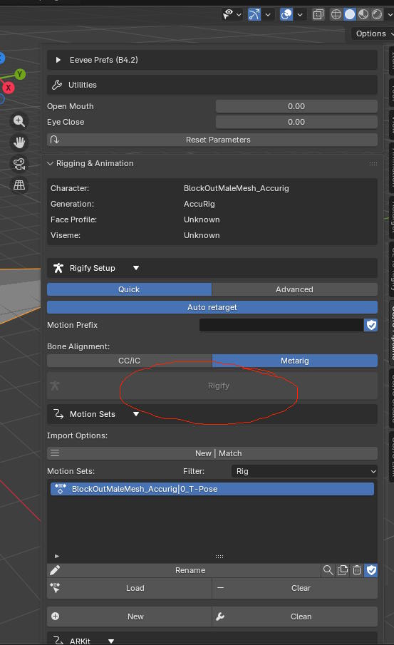

Hi,
after importing a character created in accurig 2.1.0 with the addon import button
i cannot generate the riggify rig on it, the button is disabled as in the attached screeshot
i have tried with multiple characters in blender 5.1, 4.1, 4.4.3
and blender tools, 2.3.4 and the new one 2.4.0 from github
no errors in the blender console
am i missing something or it’s broken ?
thanks .

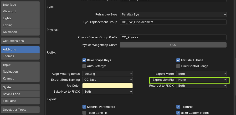

There’s a case that might cause this.
Go to Edit > Preferences / Add-ons / CC/iC Tools
Set Expression Rig to None.
That’s probably what was preventing it, as accurig characters are typically generated with no facial profile.
that was it !
thanks a lot
