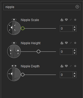

There are couple of sliders - “Nipple Scale” and “Nipple Depth” which you may use to flatten them out. Assign a negative value manually if necessary.

Thanks, set Nipple Depth to -200 works for me.
