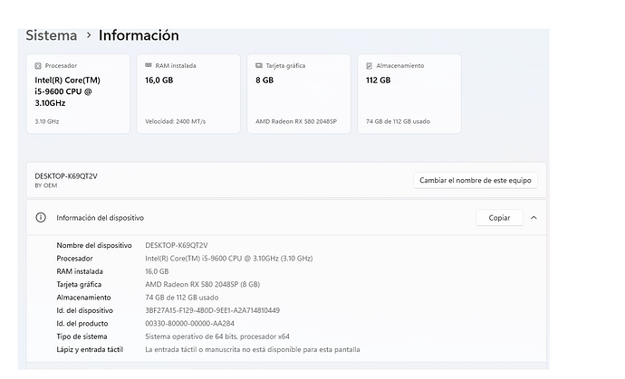

Greetings… thank you so much for the reply… I had high hopes for CC4, but it seems there are aspects of the program I wasn’t aware of, and now I need to look for alternatives. Let me explain the issues I’m having with CC4: 1) My Blender characters are ordinary people wearing clothes; they also have well-defined physiques—some muscular, some heavy-set, etc. While CC4 has its own templates, the body modifications aren’t harmonious… for instance, if you try to enlarge the chest, it does so clumsily—it doesn’t look organic or maintain the natural shape of the pectoral muscle. Clothing and accessories can only be used with the built-in templates; the software won’t let me apply them to my own custom character bodies. 2) When using Headshot, it won’t let me use a generated face on a “toon” character; it only allows for realistic human characters. 3) Regarding my machine’s specs, I’m attaching an image here (I’m not sure if I’ll be able to upload it). For example, I recently tried changing a humanoid’s skin color and the program crashed… I also tried configuring a humanoid body with a Headshot-generated head, and it crashed then, too. I just watched the video you kindly sent, and it made me think I might actually get along well with Character Creator 4 after all—but I need to be certain I’ll have the freedom to work on my characters the way I want. I look forward to hearing from you… Romer.

  3. Unfortunately your computer specs are quite low for Character Creator and iClone. You do have the 8GB Vram version which is a bonus, but the AMD Radeon RX 580 is now 8 years old and performance will be on the low side. To reduce crashing issues, it is advised to lower your real-time graphics settings in Preferences (CTRL+P). This should help with stability.
