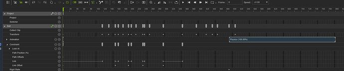

Once you have a motion, you animate a ball with ease in and out transition presets and control the preset strength to match the hand most of the time.
Nothing like a tutorial but rather a quick showcase I’ve done a couple of years back.
https://forum.reallusion.com/FindPost540983.aspx
Well, I was not just talking about a relatively simply motion like dribbling in place, but animating a ball game, i.e. switching hands handling the ball, passing the ball from player to player, having the ball fly through the air, having the ball hit or miss the basket, fumbling the ball, etc. in a way that looks realistic/physically correct. It may require a combination of physics and keyed animation.

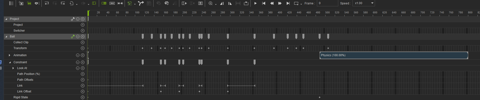

Before mocaps animators were crafting motions manually. It’s just require a bit of experience, patience and effort. Fairy simple combo and respective timeline (character motion is from a set I had in BVH)

Yes, of course. It is still required for some things that cannot be (easily) mocapped, such as motion in or under water (see the Aquatic Legends pack). And your example looks pretty good (and seems to include, as I mentioned before, both keyframes and physics), but, you are also not an iClone or animation noob. Not everybody has that kind of knowledge and skill. :wink:
