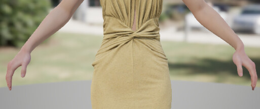

The CC5 native character works well:

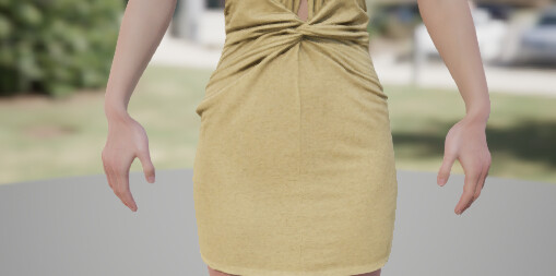

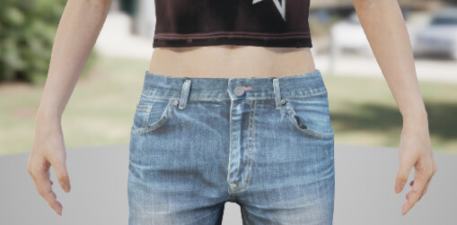

But when doing the exact same thing with the DAZ character (which, apart from being imported from DAZ, went through the exact same workflow), i get this:
I checked that the skeleton structures are identical on both characters, i tried to change the physics assets (adding/removing constraints) with no result. As soon as the arms get simulated, the wrists breaks.
As an example, on this capture, i simulated only the left upperarm and you can see that it breaks the left wrist, while the right one remains OK.
