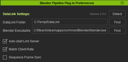

I have tons of different Blender versions installed in custom folders. I keep most frequently used updated with the same pipeline add-on. And I can fire up any version by supplying respective path to Blender executable.
Out of curiosity I installed one from Steam (have not used Steam since Half-Life 2 :grinning:)
It worked just fine as well…

The bug only happens if there is no existing config file and it can’t find a Blender path.
Putting a valid config file: ccic_blender_pipeline_plugin.txt inside your Reallusion Custom Content folder should get round it. (The folder should be listed in the content settings)

That at least should let you find the Blender path for yourself.
