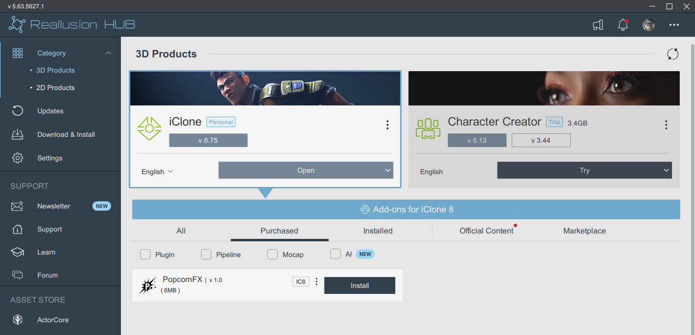

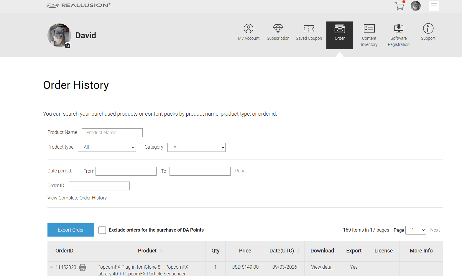

I have one account (the one with the doggo image), and here are pictures of the install in the HUB and a pic of the proof of purchase.
Hi NaturalGlitch,
After checking with our team, we can confirm that the licensed version of PopcornFX can be used with a licensed edition of iClone 8, but not with iClone 8 Personal.
Alternatively, you may use the trial version of PopcornFX with iClone 8 Personal.
