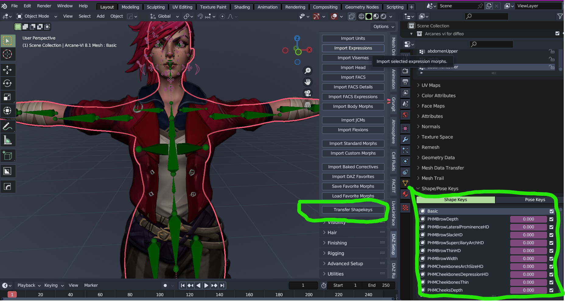

A quick tutorial on using the FREE Accurig tool from Reallusion
to create basic deform rigs for fast, easy one click conversion to an ARP control rig, with Auto Rig Pro’s amazing “Quick Rig” Addon for Blender.

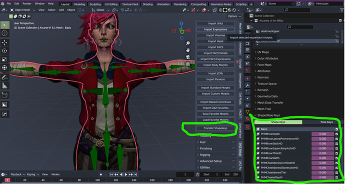

I don’t see the “Transfer Shapekey” function you showed in your screenshot. From what I’ve researched, it mainly lets you transfer shapekeys between meshes. I could be wrong or missing something, so if that’s the case, please correct me.

It does work you have to follow the steps exactly I just did a test with a Daz G8 male.
Imported him via Diffeomorphic
loaded his Daz visemes via Diffeomorphic.
Converted his visemes to Blender shape keys.(under Advanced drop down/morphs)

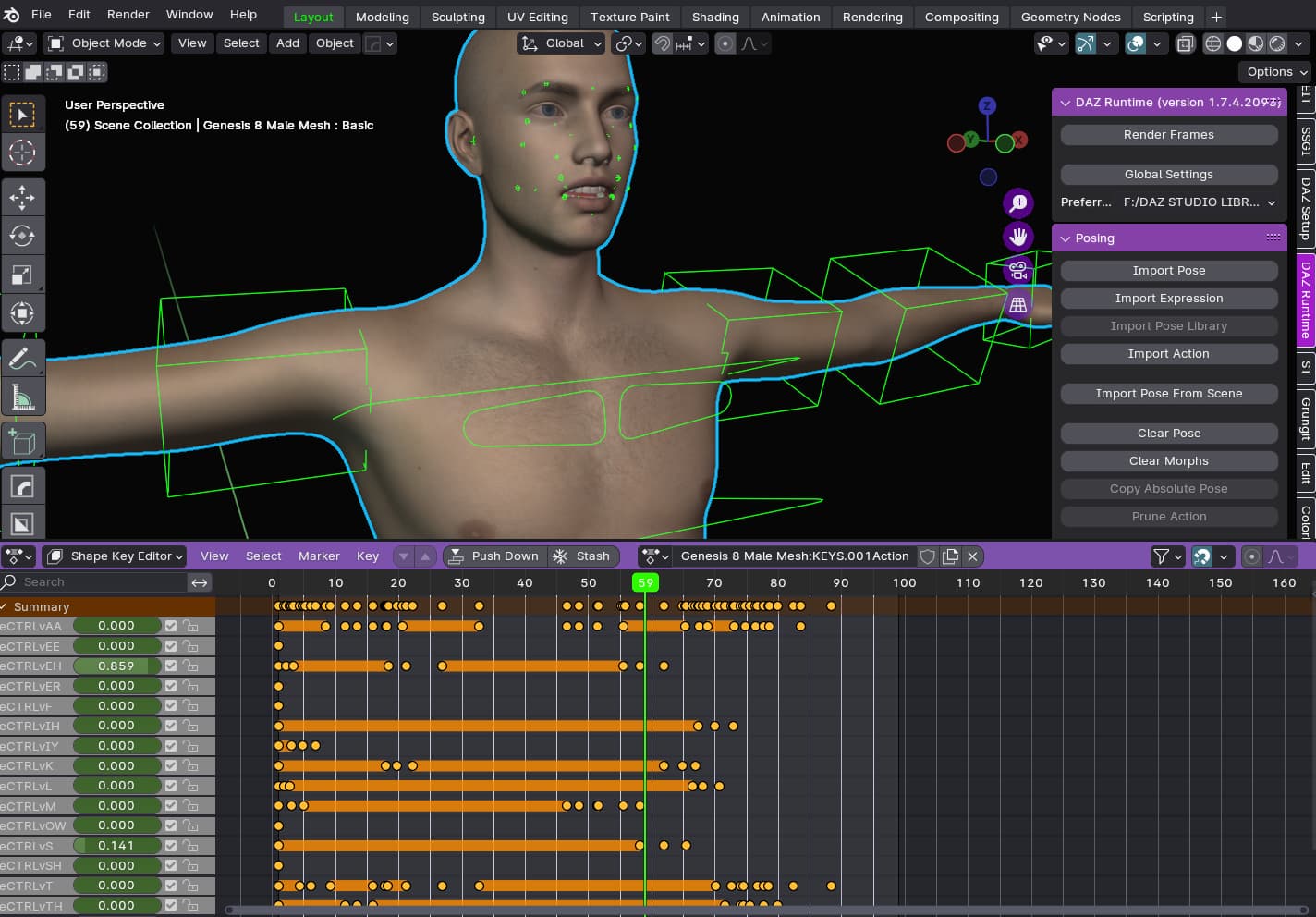

Load at least ONE Daz facial animation
from Daz studio(via Diffeo) with his RIG selected in the blender outliner.
Transfer that animation from his rig to his mesh shape keys as shown in the video.

From here on you, can load and replace unlimited Daz mimic facial animations to his/her mesh shape keys via the Diffeo “import action” button because Diffeo only needs Daz shape keys and any type of rig.
