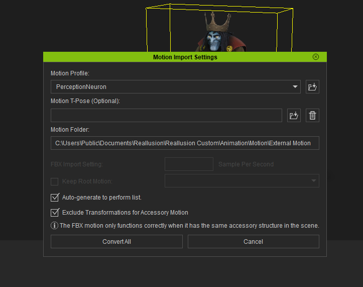

I just did a BVH import test (that was created in Axis Studio with a PN3 suit)
When I drag the BVH onto my character in iClone, it appears that I need to load a couple of files that are specific to Perception Neuron.
A Motion Profile and a Motion T-Pose file.
Screenshot below.
To save myself a long wait asking Noitom if they have the files, does anyone here have them that they could share with me?
Many thanks!
Hi… You don’t need any additional files. Your screenshot shows that the motion file has been automatically detected and the correct profile applied. The t-pose is optional and only needed if the results are not good when converted.
Hi Pete, thanks so much for your response. I did actually drop down the menu to choose Perception Neuron, but that’s great to know I don’t need to bother Noitom about getting hold of a Motion Profile file.
Great to know I can get advice from the pros here, so thank you again for your swift advice!
