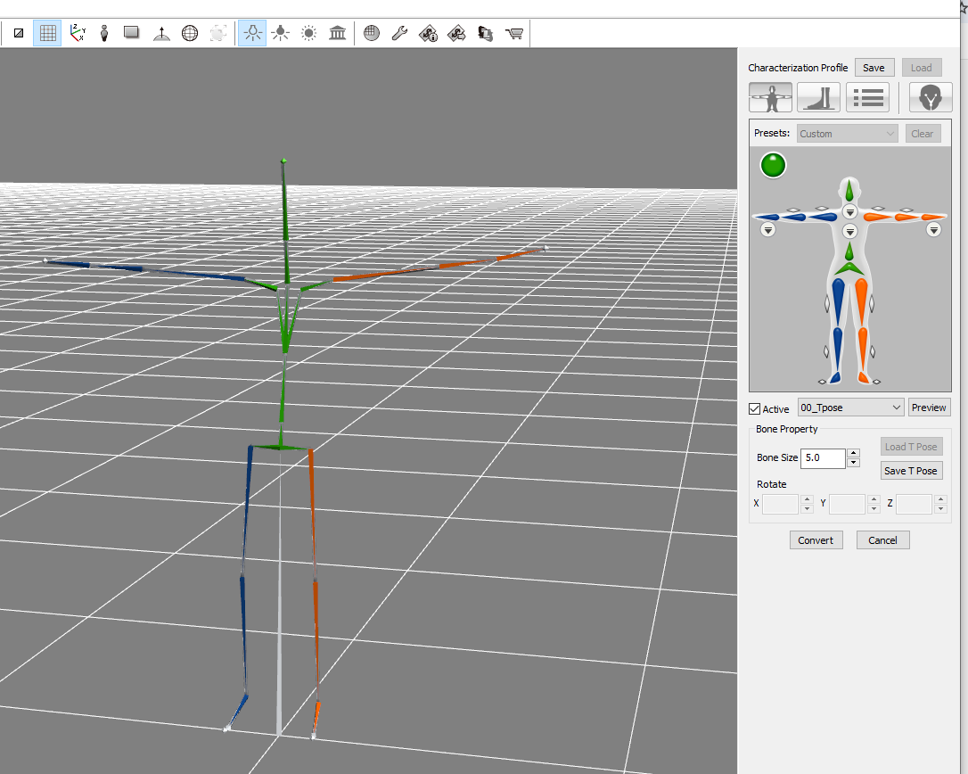

The trick is creating a “Characterization Profile” for the rig/skeleton. You have to create it the first time for an imported bvh file from Optitrack, but then you store that and reuse it for every subsequent imported bvh file. So:
- Export bvh from Optitrack
- Open in 3DXchange
- Click “Convert to Non-Standard”
- Use the Characterization Profile interface to by selecting the bones appropriately
- When you finish (get the “green light”) test it out the the sample motions
- If okay, click “Save” to save the characterization profile (you should only need to do this once)
- Click “Convert”

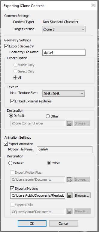

- In the main interface, click the “iC” export button. These are my settings below (the Geometry and Texture settings don’t seem to matter.) You will need to navigate to the proper Folder in iClone, for example “C:\Users\Public\Documents\Reallusion\Reallusion Custom\Animation\Motion\05_Stranger”

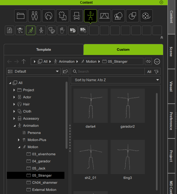

- The animation will appear in your Custom/Animation/Motion tab.
