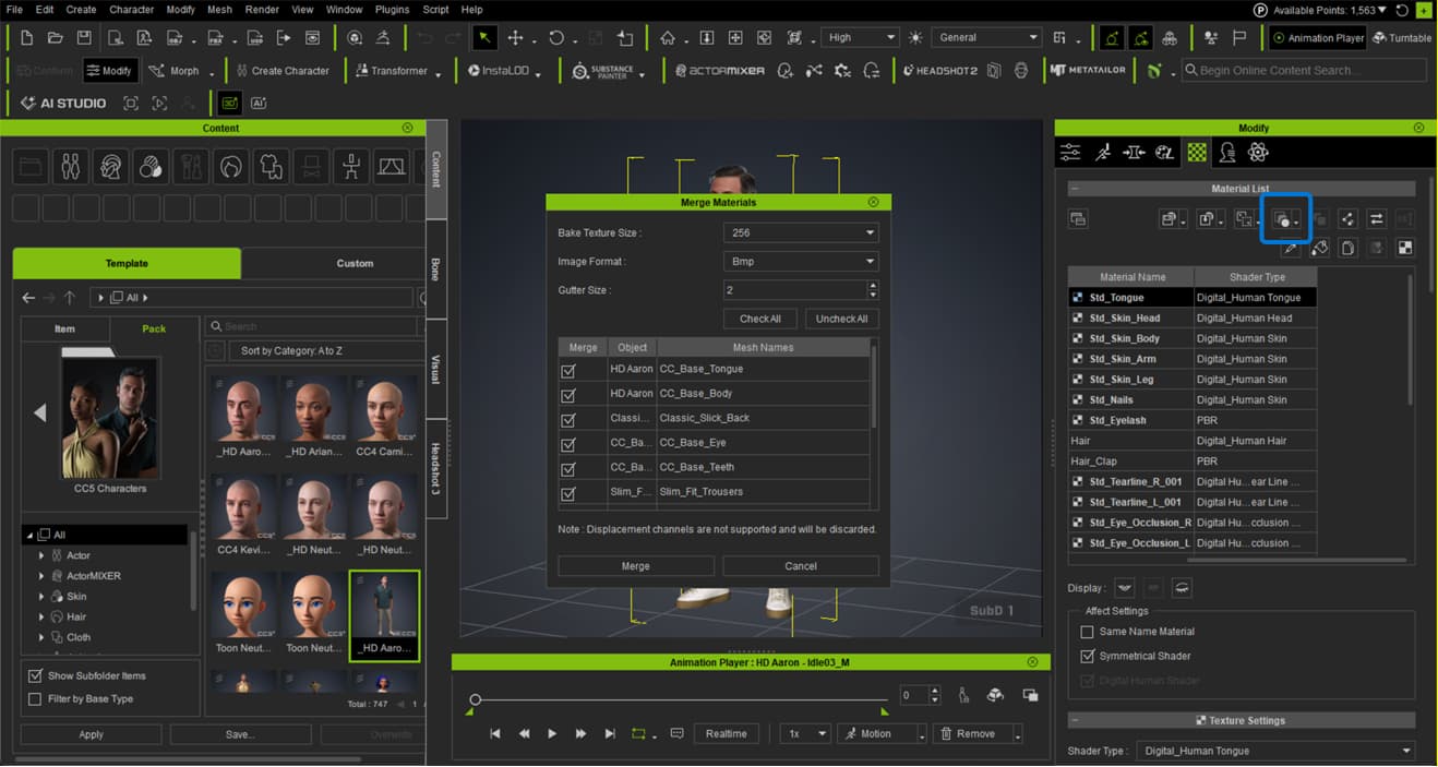

You can merge materials from the Material tab of the Modify panel.
Do this as a final step, since it converts the character to a Humanoid, and so can no longer be morphed or change clothing.
