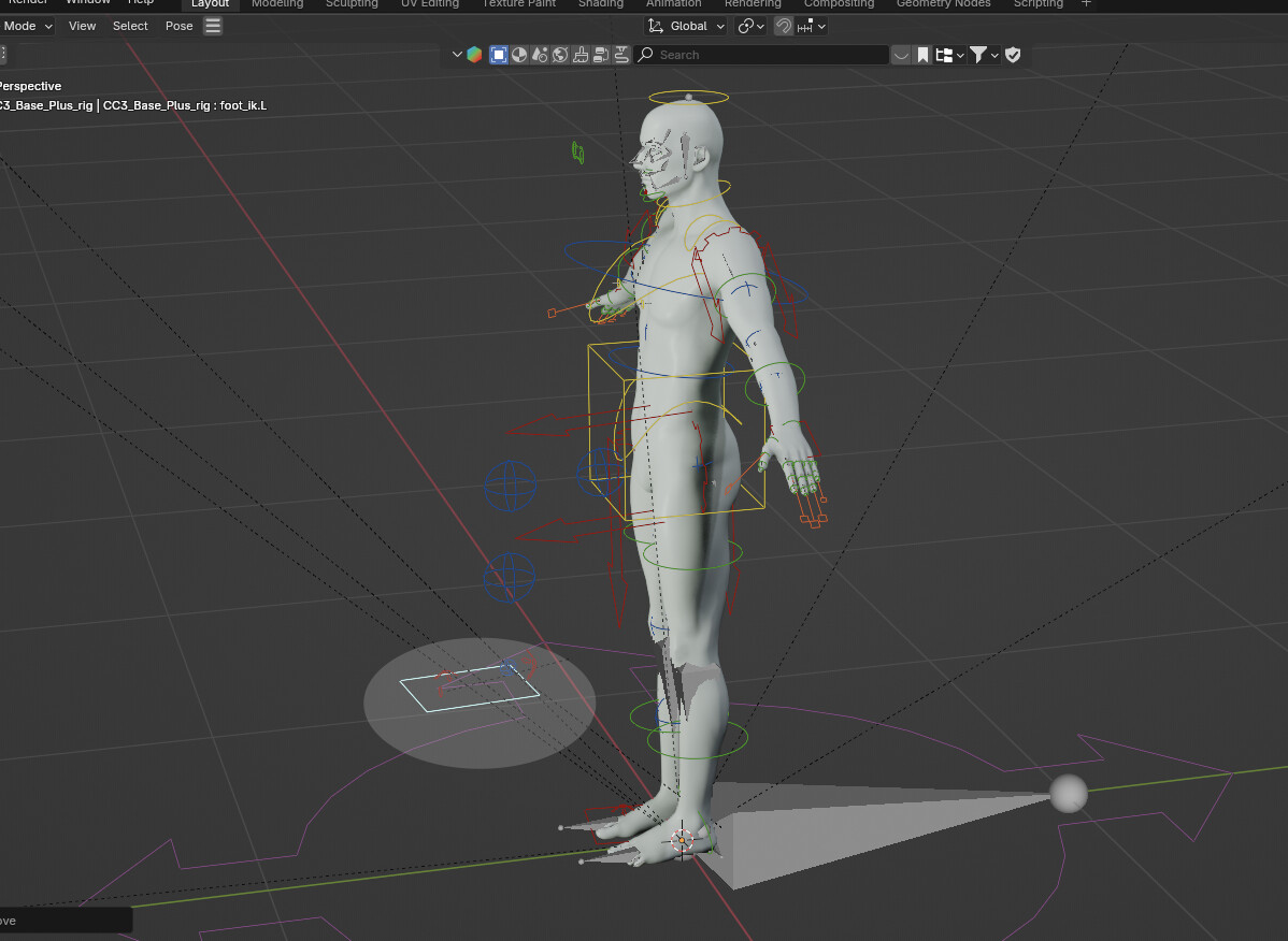

It appears that when I rigify the CC3+ Mannequin Male or Female, the mesh does not weight painted to follow the rig. It does not matter if I rigify the character from the Blender DataLink or from within Blender using CC/iC addon. When I attempt to Parent with automatic weights the body mesh scales by 10 or 100.
The other charaters I have transferred over to Blender using rigify on work just fine. I just don’t know if the Mannequin’s are not suppose to work with rigify by design or is this a defect.

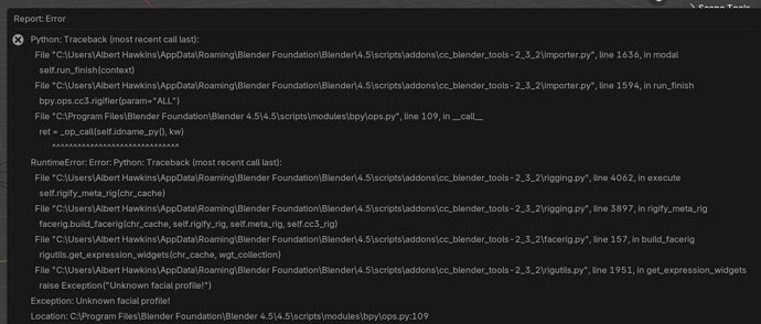

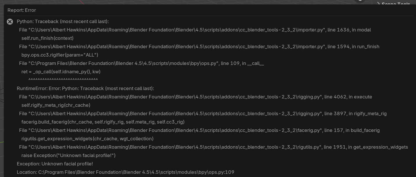

As the mannequin doesn’t have facial expression shape keys, it will fail if you try to generate a CC5 HD Expression rig with it.

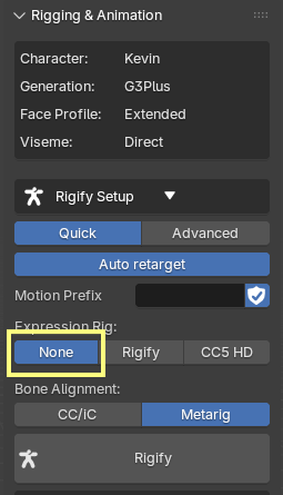

If you set the expression rig to None, or Rigify, it should work.
Thanks Victor for responding. I am using the Blender Pipeline from CC5. That being said, how do you set the expression rig to None and I am using Rigify in your CCiC Blender addon? This is the error report I get.
In the Rigging and Animation Panel:
