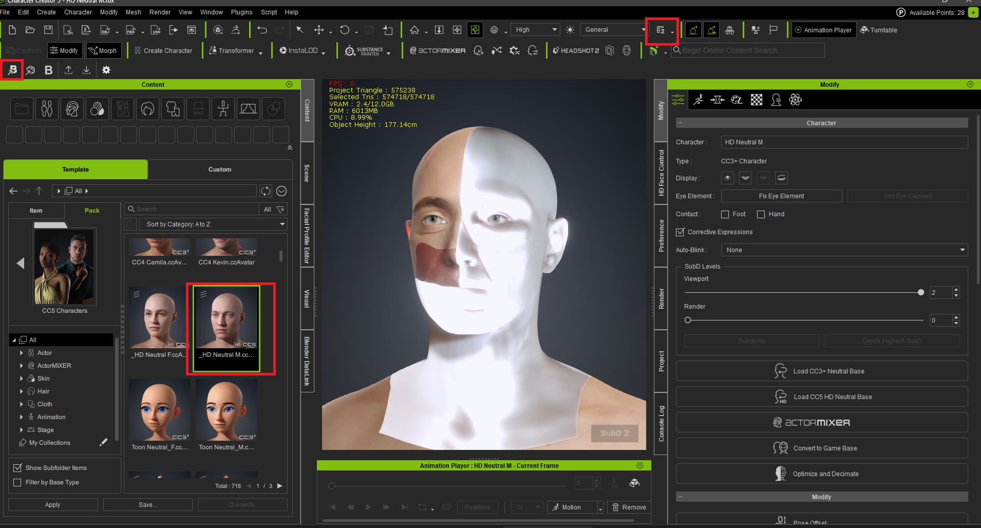

Blender Pipeline Tool
When I send a CC5 HD_Neutral with Sub Level 2 via GoB, sculpt it a little in Blender,
and then send it back go CC5, to Character Creator 5,
I get this. (See image.)
Blender Data Link
Sending material to CC5 is a bug,
see video.
Regards, Robert
