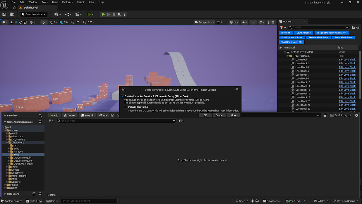

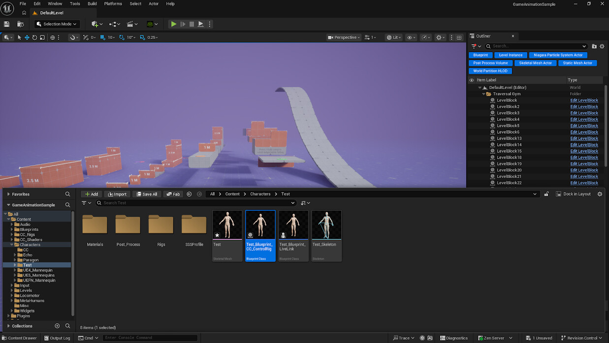

We followed your workflow and were able to find the control rig blueprint (shown in Image 1).
Can you double-check if you have “Include Control Rig” turned on? (see Image 2).
Just a quick heads-up: our UE plugin is still on v5.7 and hasn’t been updated to 5.8 yet.
