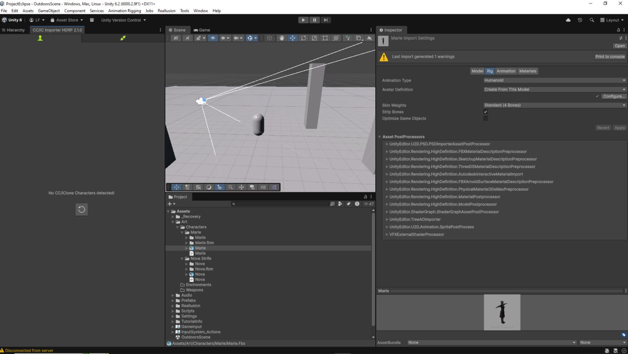

No CC/IClone characters detected
I have followed all the steps I could find to install, export and import but my characters just doesn’t get noticed by the unity auto set up plug in. I noticed this server connection section that says disconnected and if I try to connect it it doesn’t connect but none of the guides online make any mention of this.
I don’t see the Textures folder.
It looks specifically for three things to identify an export from CC/iClone.
The files:
  • Name.fbx
  • Name.json
The sub folder:
  • Textures/Name/
The Textures are in the Folders named Marie and Nova. Does it matter if the folder is named something other than Texture?
Yes it does. It’s very important the folder structure is not altered.
