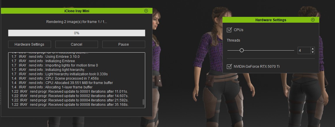

iClone and CC4 have been set up through nvidia to use the graphics card as GPU. When I do an iray render in iClone, initially you see activity by the GPU when the scene is setting up to render, but the minute the second box that shows the progress of the render pops up, it no longer shows any activity of the GPU and it’s very slow. Takes close to 1/2 hour where before it was a couple of minutes.
So, is it actually iray that doesn’t like the new video card? I should mention that when rendering, if I click the “Hardware box” and uncheck CPU - the render just stops and says there is no CUDA capable GPU.

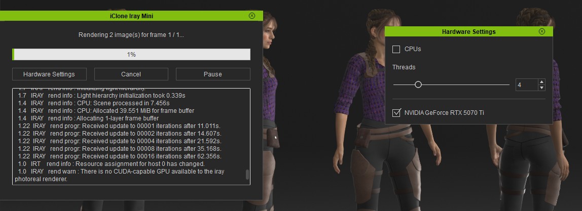

Oh wait…when we unchecked the CPU box and the video card is checked - the iray message came up with no CUDA processor available or something like that.
I was reading on my phone, we already had gone through that and it was not working -
Screenshot 2025-06-09 174804
As soon as I uncheck CPU - the render stalls and says no CUDA processor available.
