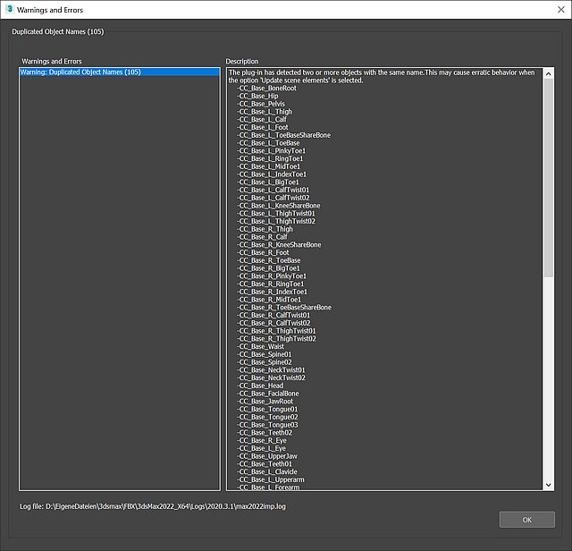

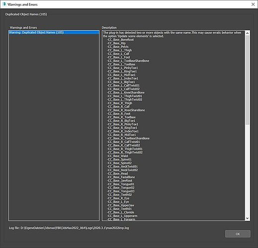

I am animating characters in iClone, export them to FBX and import them in 3ds Max to render with V-Ray. When I change something in iClone I can basically repeat the steps to update the existing animation in 3ds Max without losing the work done for materials etc. This works okay so far, until I tried to put a second character in. Then I get lots of naming conflicts during FBX import, because even with different characters with different character names in iClone, all the objects are named the same (“CC_Base_BoneRoot” etc.). Is there a way to give every object in iClone a unique name or am I doing something the wrong way in this pipeline?

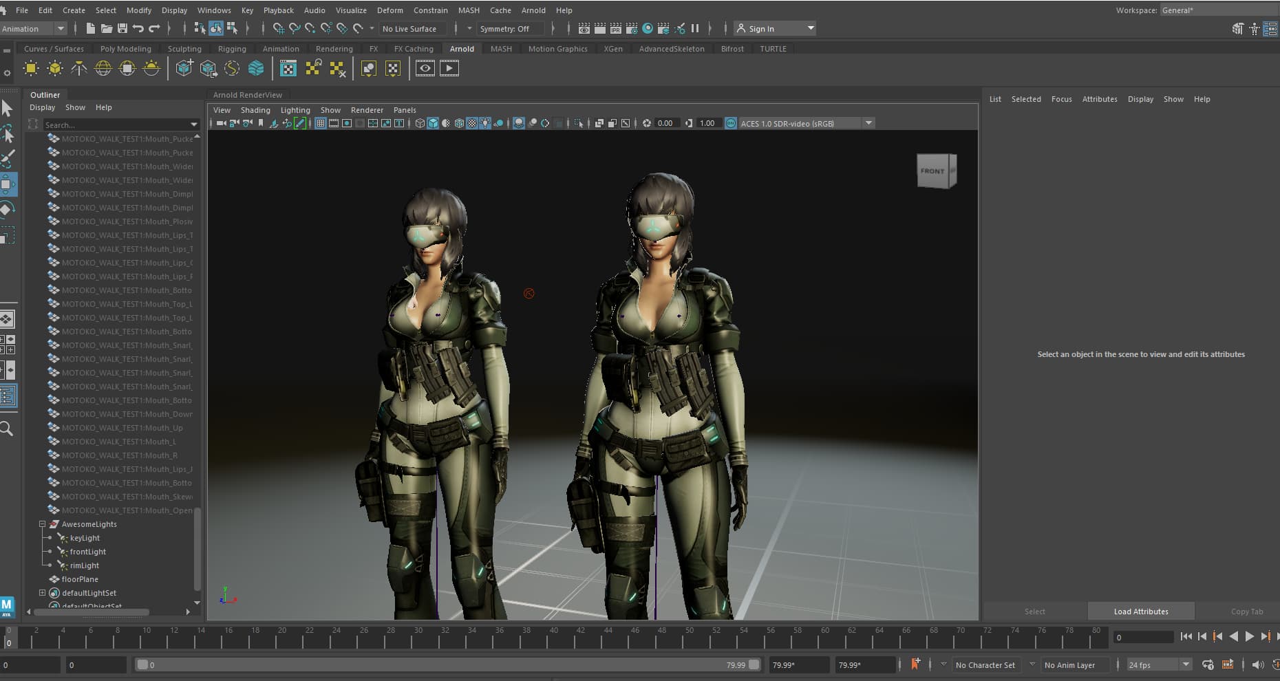

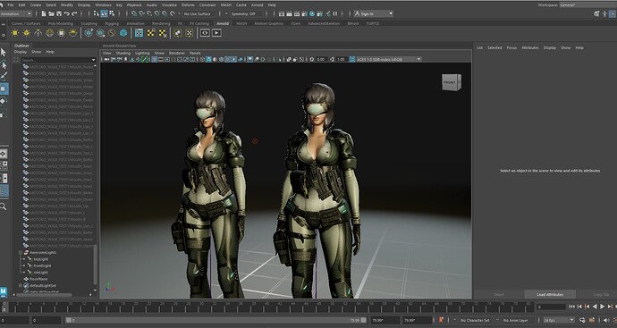

I am not a 3DS max user but I do have/use Autodesk Maya
and it seems inconceivable to me that max cannot import or reference two identical copies of the same FBX file without conflicts.
I just tried it in Maya and got two copies of the same CC3 FBX export with no errors
there must be some import or reference setting in Max you are missing somehow.

Thanks for your thoughts on that problem. I do can import different FBX characters, as long as I use the “Add”-option in the FBX import options. The problem occurs when I change the animation in iClone, re-export as FBX and try to re-import into 3ds Max, this time using the “Update”-option, so I do not lose the work done in 3ds Max on materials, changes to the geometry etc. and just update the animation. This is when the FBX importer does not know which “CC_Base_BoneRoot”-object it should update for example. Ignoring the error results in chaos.

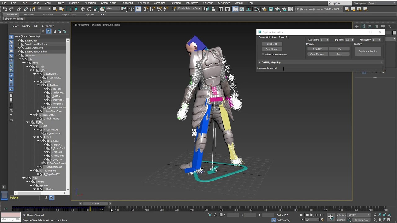

why not just use the add function to import the new updated animation and retarget it to the fully textured Character with 3DS Max’s retarget tools as this is guy is doing
in this video.
Thanks again! Unfortunately this Retargeting-function is a specific function for characters rigged with the CAT system, it cannot be used to retarget one FBX skeleton from iClone with another. The target rig has to be a CAT rig. Newly rigging and skinning every iClone character would be a lot of work of course. But you made me think of trying a different function, the save/load motion funtion of 3ds Max. It takes longer and more steps than just using the FBX update but seems to be a usable workaround, thanks. I wish I could just give a prefix for the bone names in iClone on export, it would make things so much easier…
