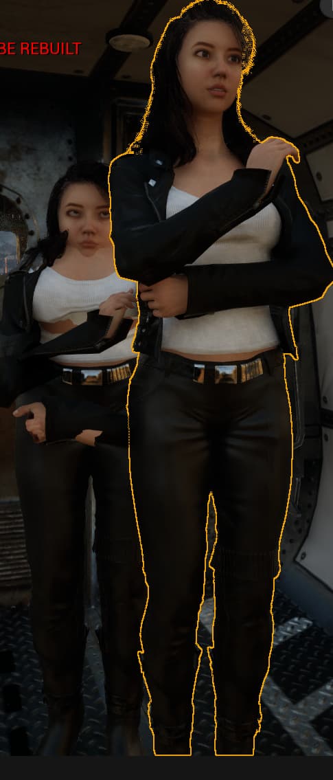

Hi Larry, I have a similar problem I think. I upgraded iClone which also automatically upgraded the livelink plugin from 1.35 to 1.37. Now all my custom CC3+ characters in my UE5.3 project seem to be missing some bones info which makes them appear squashed vertically. Hope there is a fix for this.
