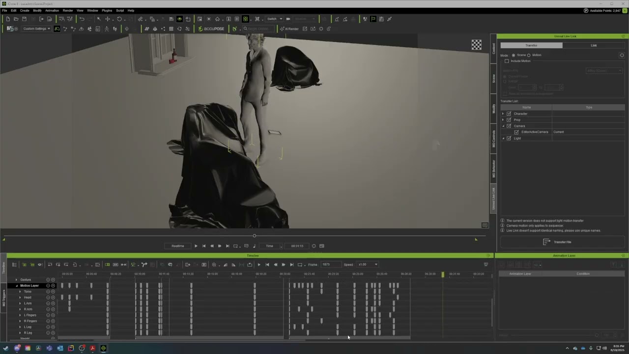

I have been using Motion Direction to do my walking animations since it gives me a pretty good base to edit a walk animation from one location to the next. However the last time I used it, it seems to have broken my project. Character is stuck to one location, there’s an idle animation that is not present as a motion clip on the timeline overriding everything else. Even when I scrub to the end of the timeline where there’s clearly no motion clip/layer it is still playing.
Motion director is not active and I can’t get back any of the animations I’ve worked on. This is frustrating as I’ve potentially lost a couple weeks of work on this. See video below. Any assistance is appreciated.
I still have not figured out a fix for this. No idea where the extra animation frames are coming from, but at least it seems I can export the motions on the timeline and have them be unaffected, so I’m working to migrate into a new project. Hoping there isn’t too much loss.
I’d recommend escalating this to customer support or the FT team, as it looks like they’ll need to open your project to check if there are any hidden frames affecting your animation. Hopefully, the migration to another project goes smoothly for you.
