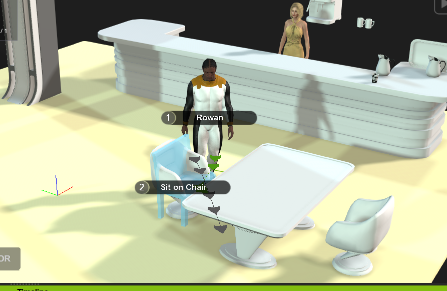

For example, I created a project, imported some props from UE, then added a simple walk animation with MD. When I then go to use the “sit on chair” MD prop, it looks correct when first creating the motion:

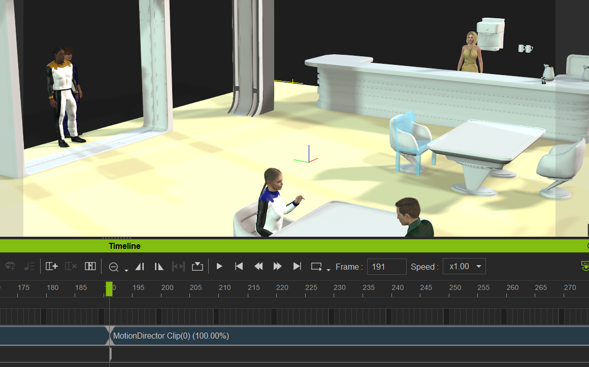

But when I create the clip, the character goes back to his original location, before any animations were added.

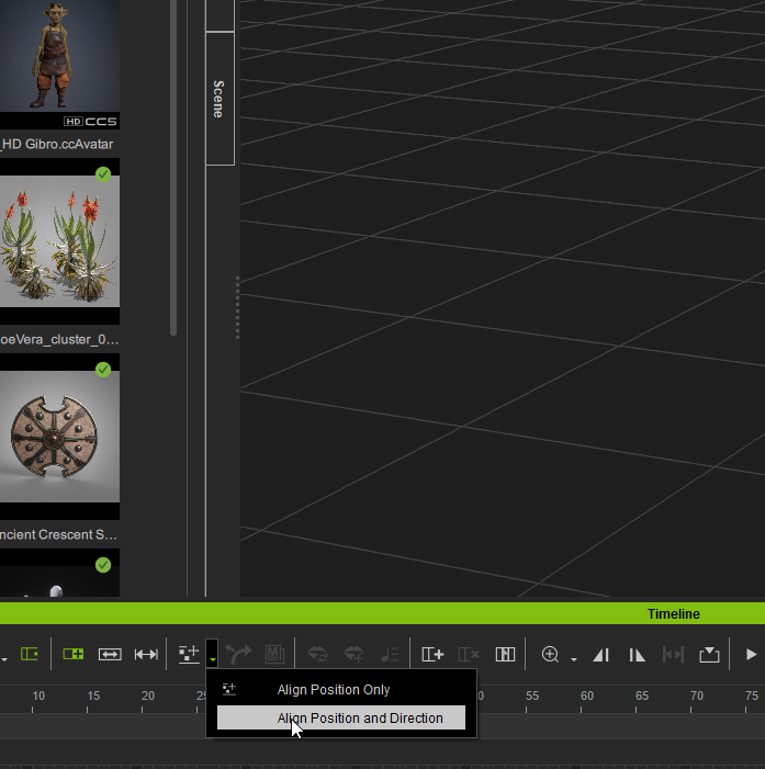

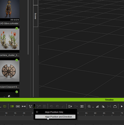

Also, please make sure that Align Position and Direction is selected when creating the clip.
