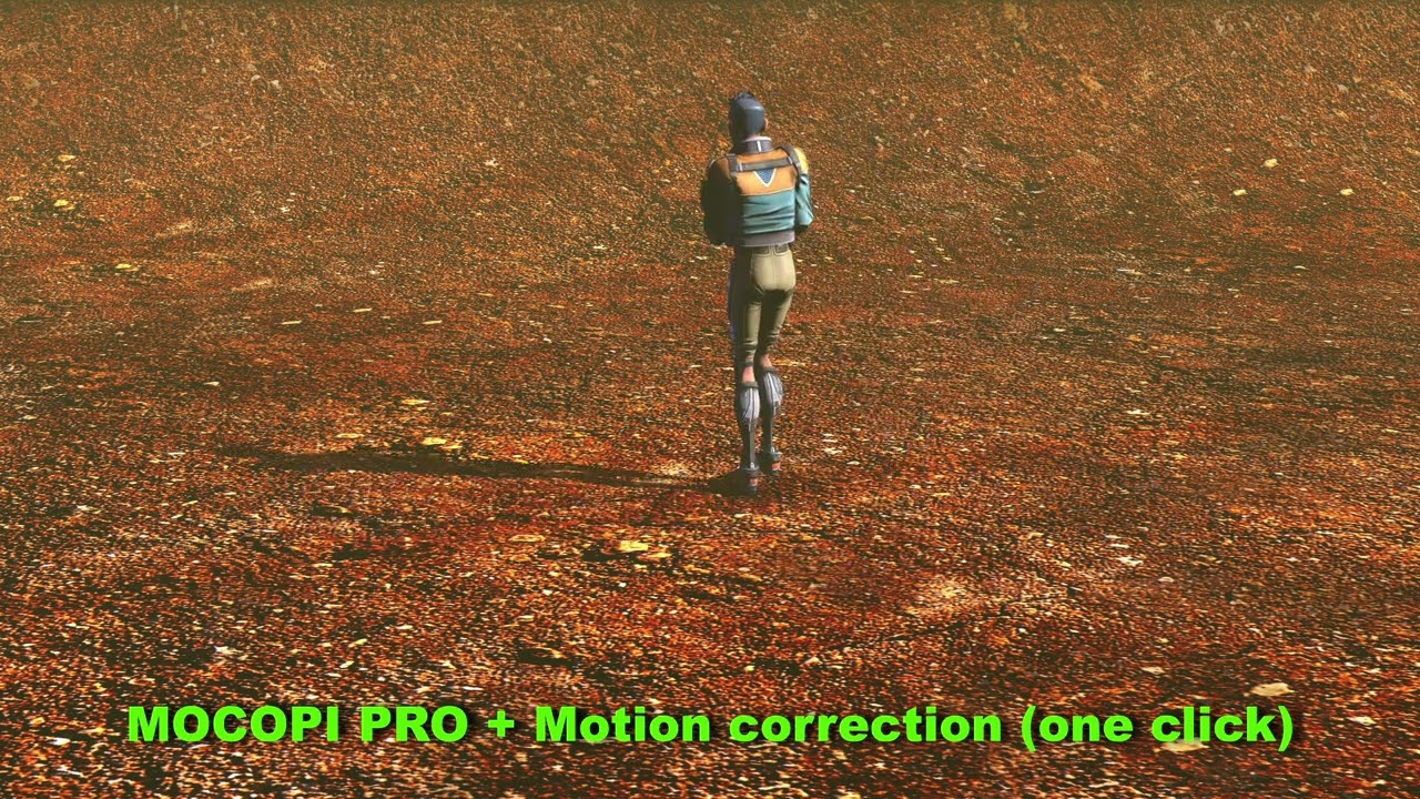

This is a test I did with mocopi pro. At 50 seconds I made small jumps which most likely shook the hip sensor, which produced some jitters. I didn’t correct them because it takes too long. It’s better to redo the shot. I used the motion correction feature and a single click fixed almost all the feet sliding issues.

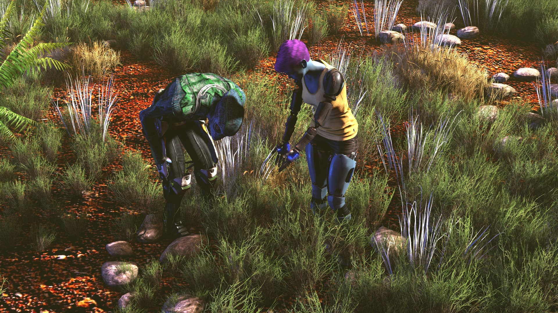

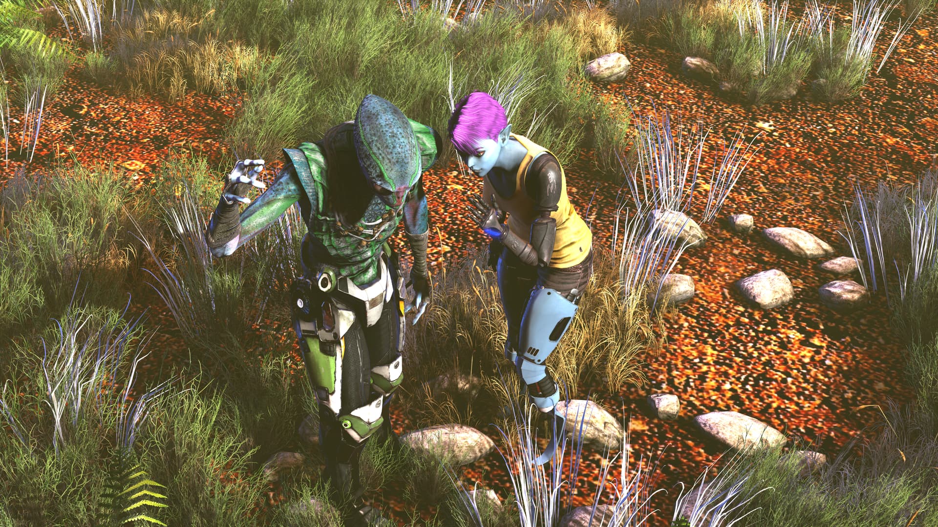

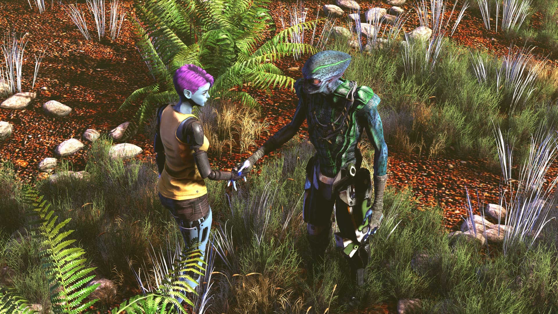

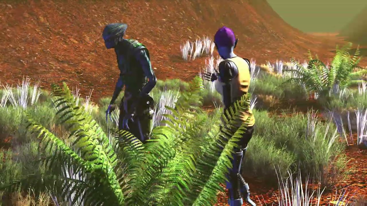

Because mocopi pro requires 2 mocopi kits, I did a test with my son of a simultaneous recording with interactions. The sliding of the feet is more pronounced. But the biggest problem is that as the recording progressed our positioning shifted. However, the starting position and the arrival position are correct… Maybe it’s due to the iPhones which were not the same model. I used an iPhone X and an iPhone 12.
At 30 seconds the handshake should have been like this:
At 47 sec the oven inspection should have been like this:
At 59 sec the look through the window should have been like this:
In conclusion this is for me the most effective piece of equipment I’ve ever purchased. (I purchased Neuron V1 , Rokoko suit and camera to motion, tested
video to camera…) It’s good value for money. Easy to install and precise enough to avoid spending hours cleaning up your motion . It’s the ideal tool for dialogue and simple movements.
