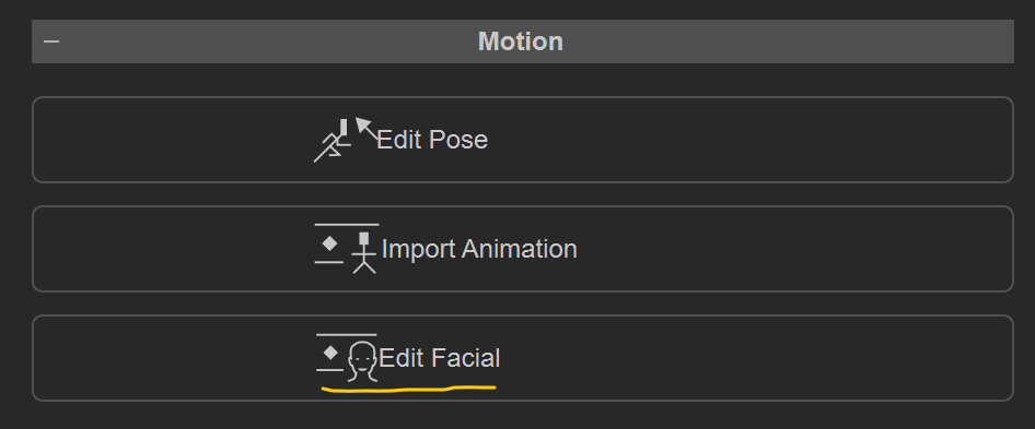

Essentially I need to optimise the character for mobile augmented reality however I can’t seem to apply the facial performance to say for example an ActorBUILD decimated character.

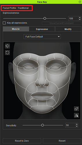

Could you please check which Facial Profile your ActorBuild character is using?
You can refer to this section in the UI (you can open the Face Key panel to confirm).
If it is set to “Traditional,” it is possible that the character is using the older IC expression set, which may cause many facial sliders to behave differently.

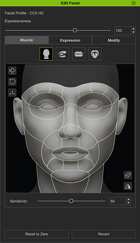

Sure thing, it says the facial profile is CC5 HD:

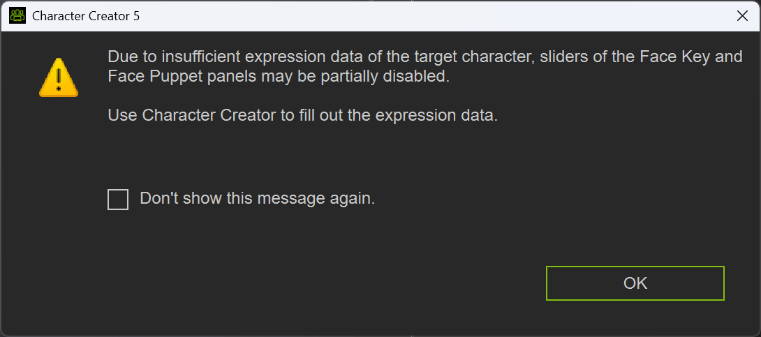

However worth noting when I click the edit facial button to bring up the UI this message comes up:

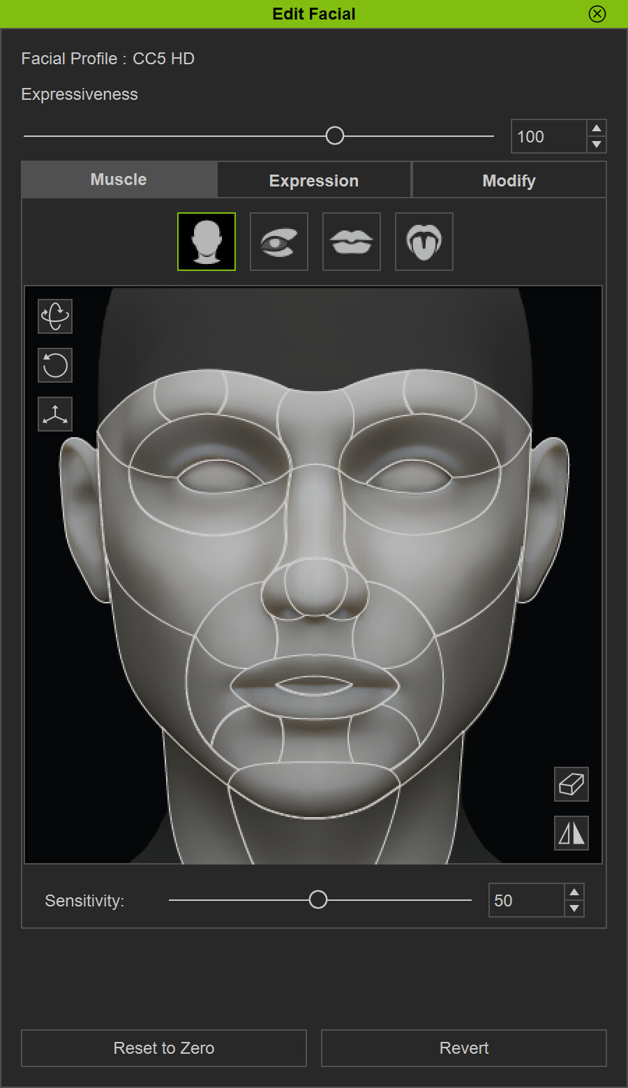

Hi noel_961591,
At the moment, we are unable to reproduce the issue using CC5 HD characters. Therefore, we would need your assistance in providing either the ActorBuild character or the CSV facial expression animation file for further investigation.
