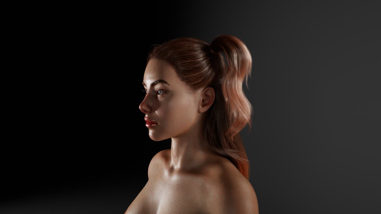

Hello. I exported my character to Marmoset toolbag using the plugin, but the character looks really weird. The texture is different the hair color is different. Is that supposed to be expected?

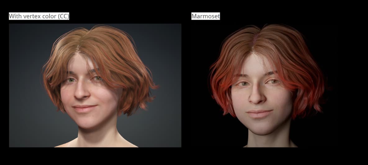

Currently Marmoset toolbag 5 does not support custom shaders yet, so it is diffucult to fully match the visual quality of other Auto Setup tools (like Blender).

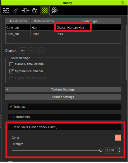

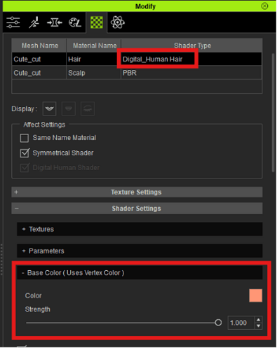

The CC Hair Shader’s vertex color cannot be used directly in Marmoset, which may cause color differences, as shown in the example below.
At the moment, users will need to manually adjust the hair materials.
