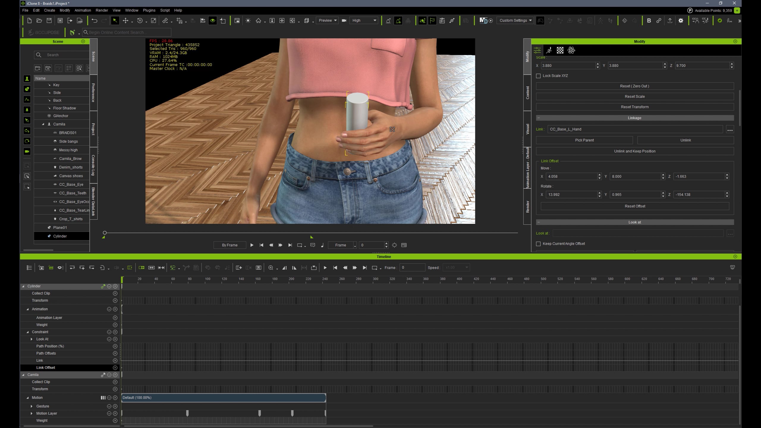

I haven’t noticed this “Linking” issue before but it still could be something I’m doing wrong…or maybe a bug in iC 8.52.3 . When I link an object a second time the first link “drifts” away from it’s original point.

Yeah, they messed it up… If you look closely, during unlink the link offset key is not created to fully bake the position. So after unlinking, select first offset key, and use Split with right mouse click. Then copy it and paste to the key where you unlinked the object.
In other words…
Ah, so it is messed up! Not me this time I’ll try and see if I can figure it out from you explanation …THANKS!!!
Also, am I to assume this is iC version 8.54? I’m using 8.52 and I don’t see that “Split” function. Although the Copy-Paste" function seems to do the job.

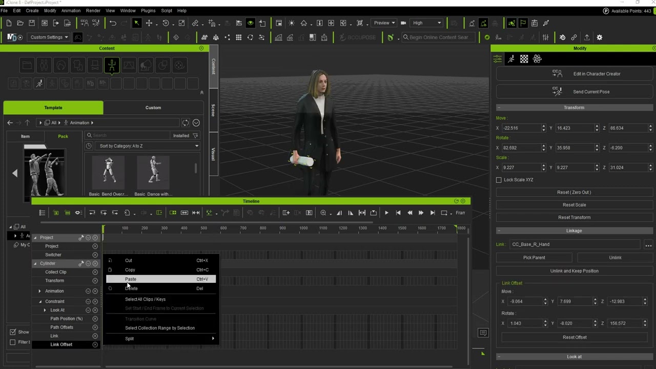

Hi Mark and 4u2ges
Please find below a video from Luke (Dev team PM) which shows how to resolve this issue. However, Luke thinks there is still an issue that needs to be fixed and this will hopefully come in a future update.
That’s what I have basically shown in my video : Copy/Paste Link Offset key because it is not created with Unlinking objects.
