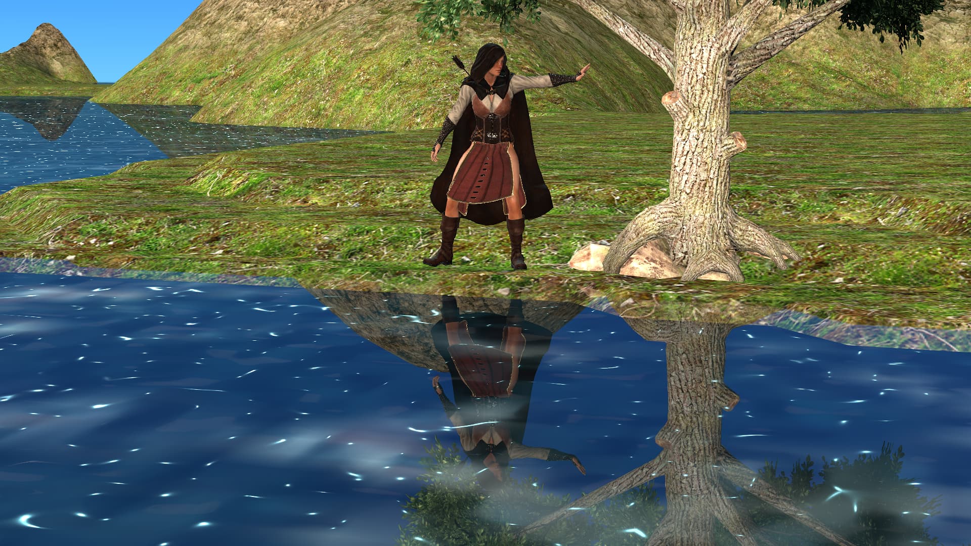

Lake with Reflections and Highlights
I wanted a lake that looked like the little pond in front of my patio. It was supposed to have reflections, and the highlights were supposed to move gently with the waves.

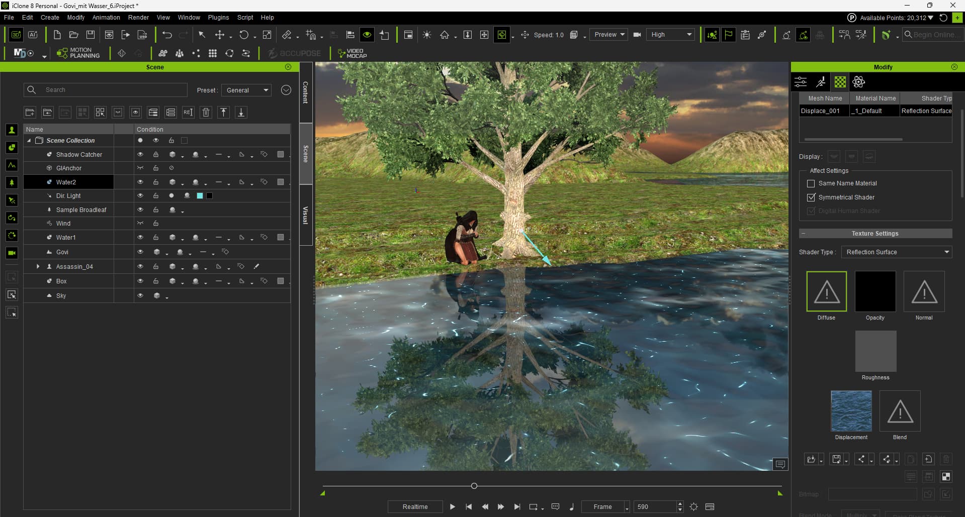

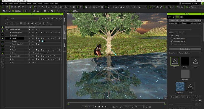

The water consists of two layers. The top layer is for the reflection. In that layer, the roughness was made darker and the opacity was set to fully transparent.

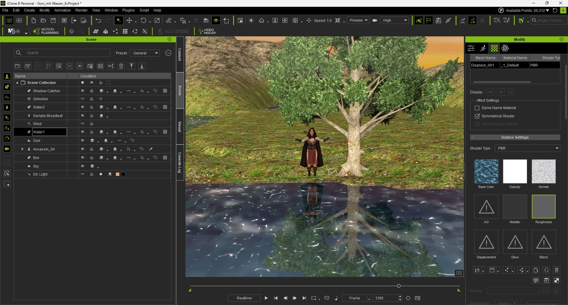

The second layer is the water layer, where the highlights are created.
