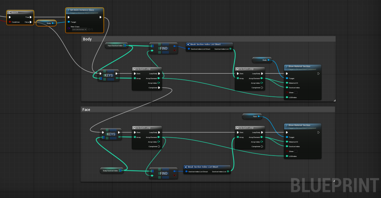

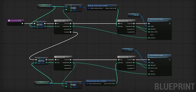

Before AutoSetup version 1.41, we hid the mesh on the skeletal mesh by disabling the materials. However, this method caused Unreal to crash when applying groom hair, so we later switched to hiding the mesh within the Blueprint. We will continue exploring the best approach to handle this.
For now, it is possible to manage this using a Construction Blueprint. I will try to explain how to do this manually until we have a quicker solution.
Many thanks for your response.
Do you haave tutorial about how to do this manual procedure?
Hi, igorpichardo159
Here is a basic tutorial video.
How to Separate the Body and Face

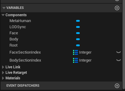

The essential step is to copy the Construction Blueprint, along with the two variables FaceSectionIndex and BodySectionIndex, from the CC character Blueprint to the MetaHuman Blueprint.
If you are replacing the full body, connect it to the Body Keys. If you only need the head, connect it to the Head Keys. If you only need the body, connect it to the Body Keys and disconnect the Face.
We apologize for the inconvenience. We will work to find a new solution that does not require this level of manual setup as soon as possible.
