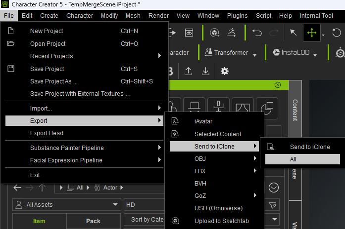

Hi dohnaee,
I’d like to check whether you’ve used File > Export > Send to iClone > All.
If you use the other button, it indeed won’t send XY coordinate values to iClone.
But All should meet your current needs.
