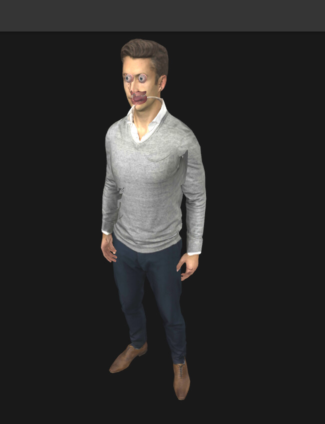

I used cc5 to blender with the pipeline plugin to export to glb and this is the result i have i’ve tried a lot of thing but im stuck, do somebody know how to resolve the issue ?

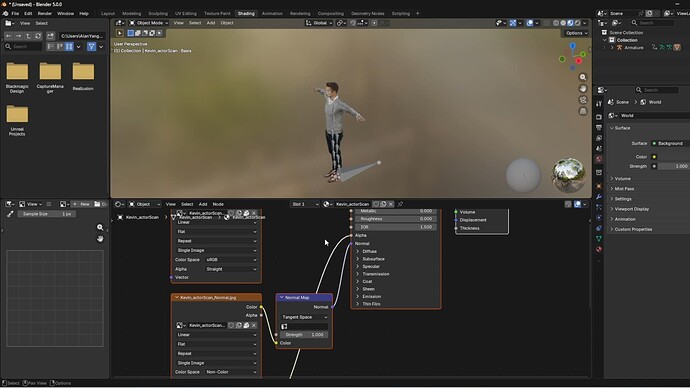

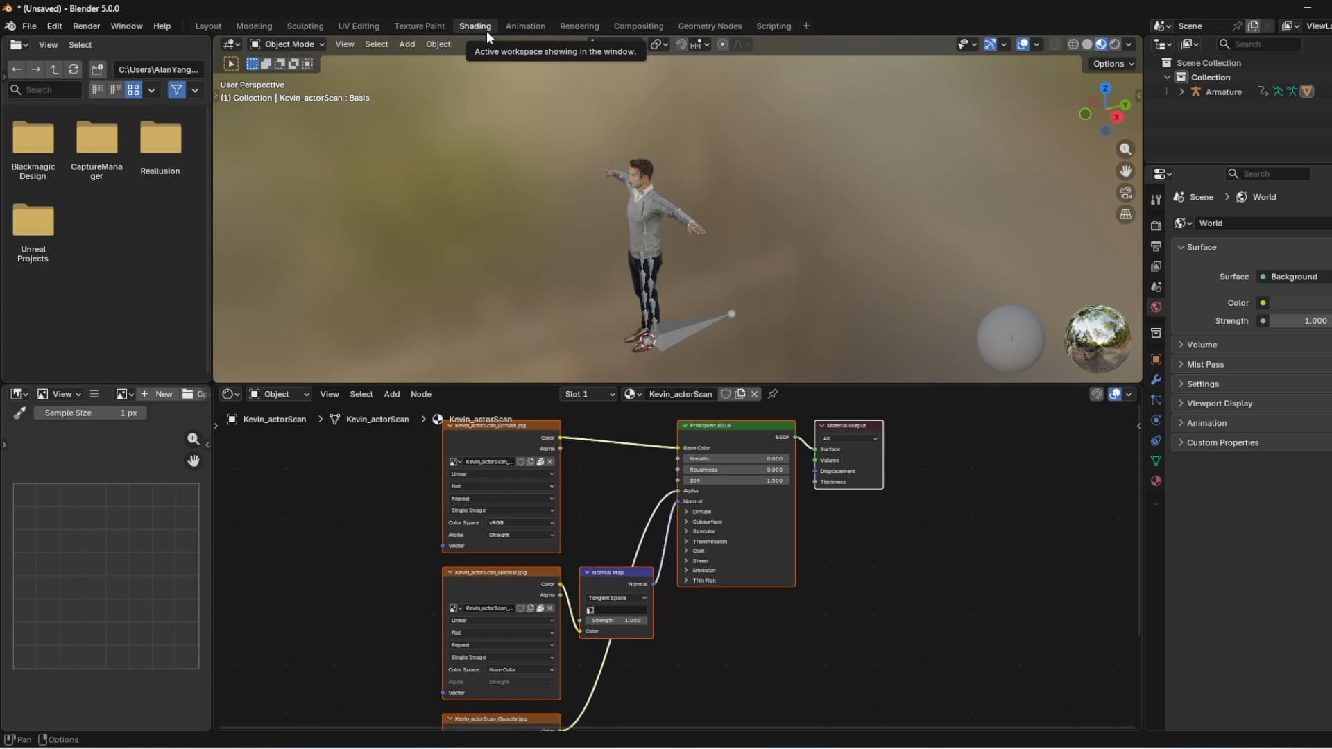

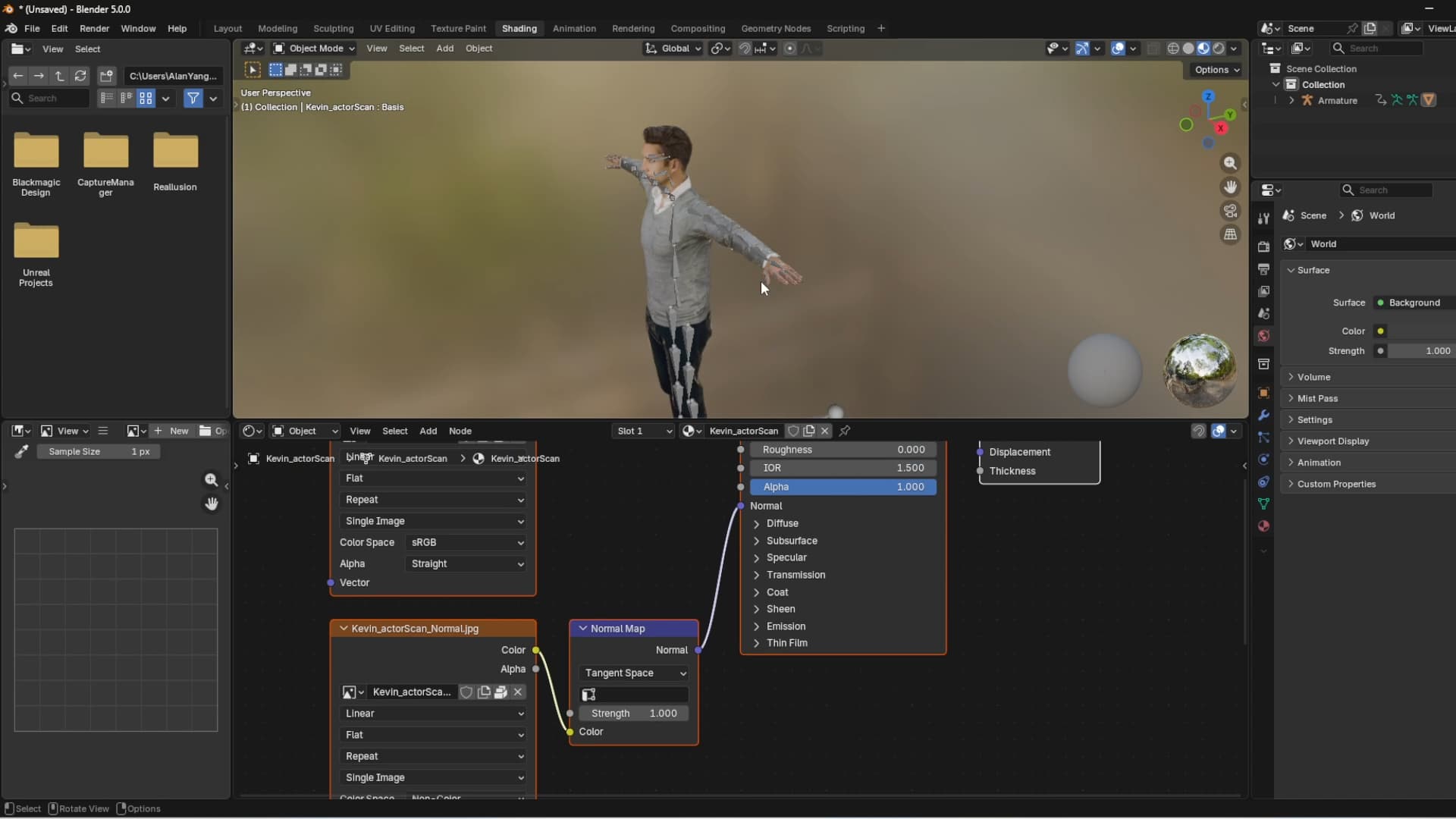

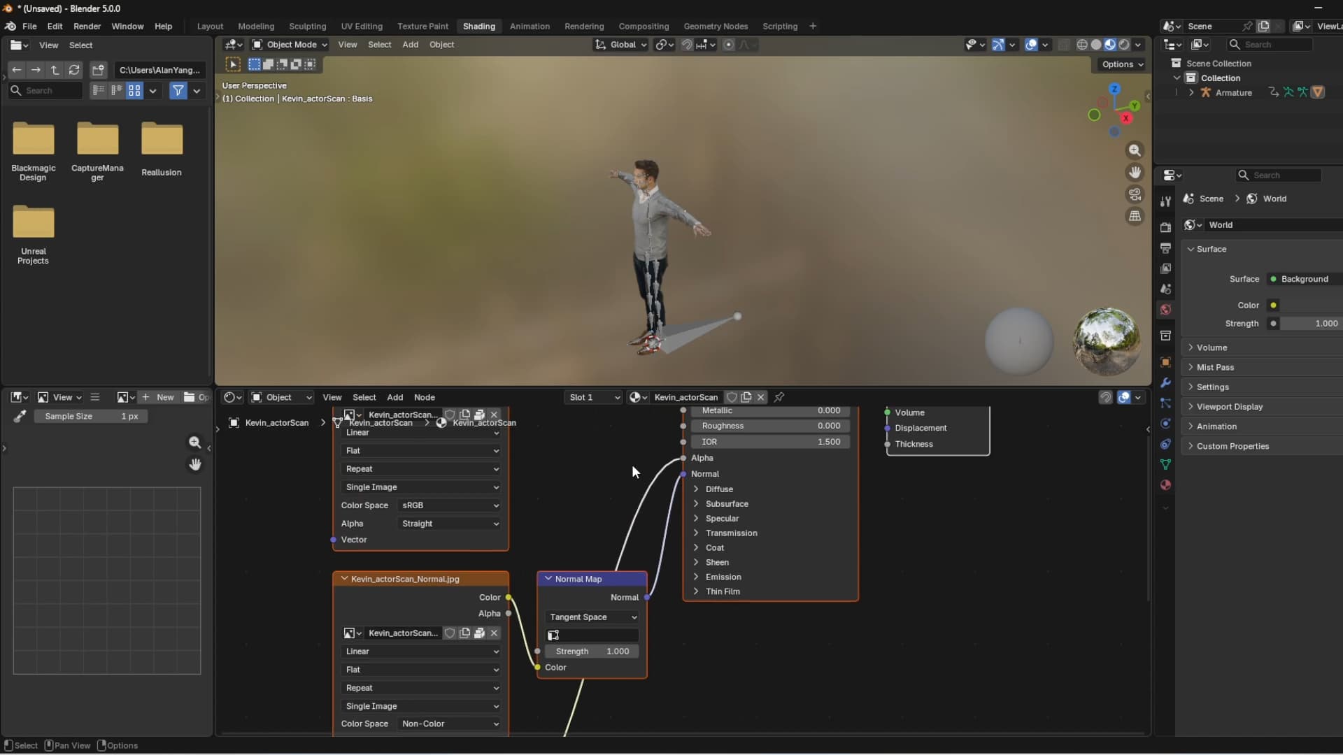

alan found the solution and sent me a video , on blender on the shading menu on the top of the windows , on the principal BSDF node unlink alpha , it’s the alpha that cause issue.
Very good support team :raised_hands:
Before :
After:
