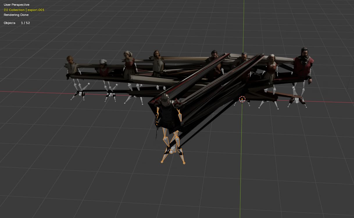

Is there a fix for this bug yet? Misplaced vertices
A lot of the times when I send my characters to Blender, I get misplaced vertices stretching everything out because they stay in place. I’ve tried weightpainting but that didn’t fix it (or I’m doing it wrong). This is unworkable for me, I can’t use motion director with too many characters. Is there a fix yet?
I see what’s going on. It’s much more obvious with that screenshot.

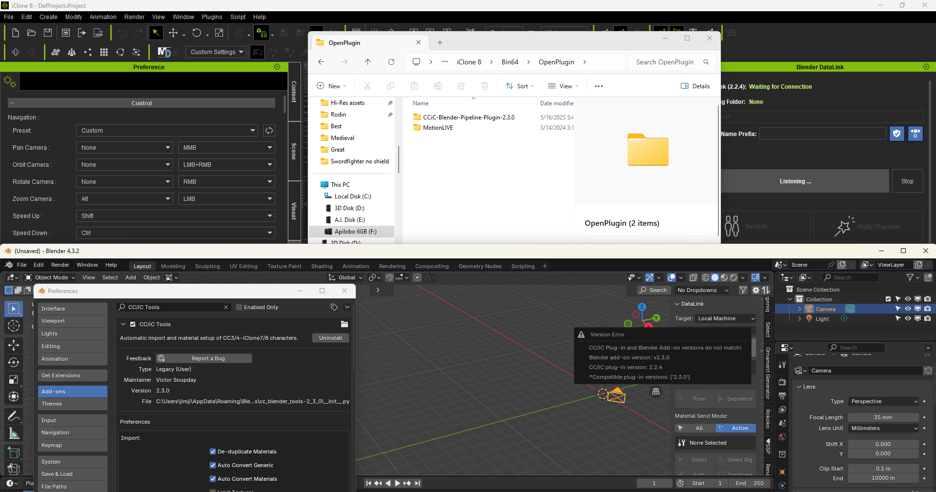

I’ve pushed a possible fix for this: Release CC/iC Blender Tools Add-on 2.3.0 · soupday/cc_blender_tools · GitHub
You will need to install the plugin for CC4 & iClone manually into the OpenPlugin folder (but remove any old versions of the Plugin from that folder first) to get it to work with the DataLink.
That should fix it if it’s what I think it is.
That was quick! But now I get the error that it’s not the correct version again.
EDIT: oh I see that iClone is running 2.2.4, did I put it in the correct folder? I did delete the old one.
EDIT 2: I just discovered that it’s installed in 2 locations… anyways, the update is now installed, I will test it out now.
EDIT 3: It works!!! Thanks a lot for the quick fix!!!
