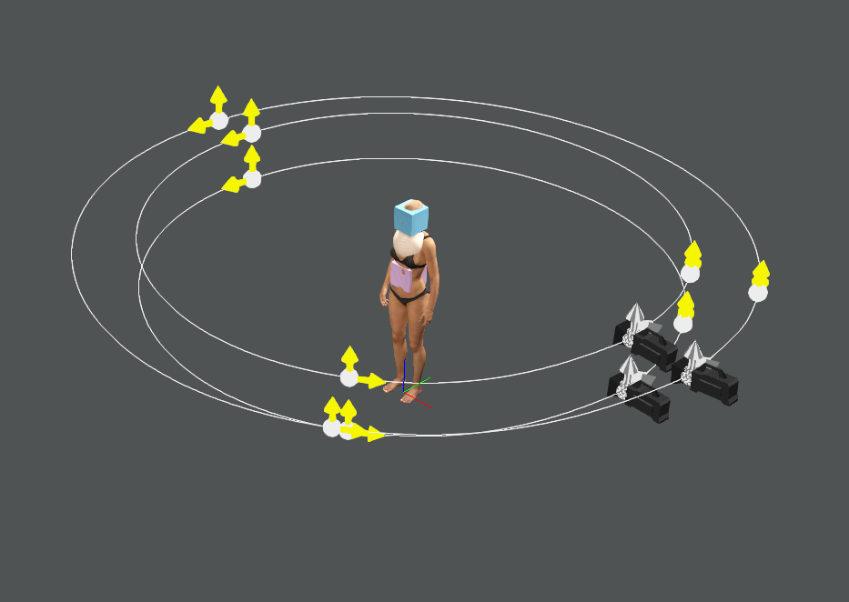

Is there a way to save a Camera with an attached path workflow and reload it easily?
Thank you in advance for a solution,
Best regards
You can attach Camera and a Path to some dummy prop (such as box) and save the box.
The camera link to path however does not “survive”. Meaning after loading saved dummy back to the scene, you would have to pick the path for camera all over again.
But generally it’s a good idea to always attach cameras to a dummy prop and then pick a path through that dummy. Props are more flexible than cameras when it comes to animation. After configuring path properties and position on a timeline for a dummy, you may use “Flatten All Motion with Constraint” on a dummy and get rid of the path altogether.
