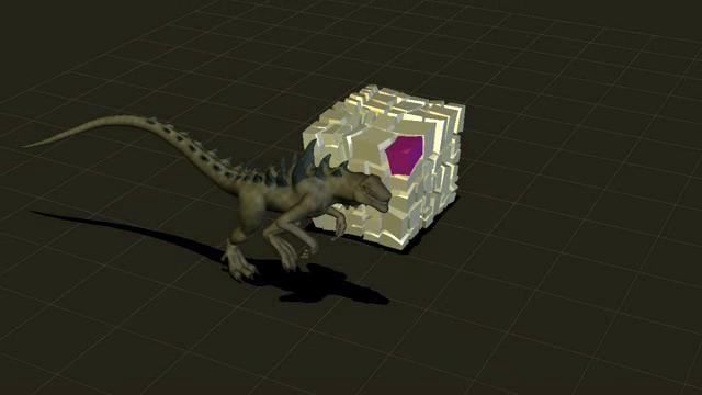

Here is the open source python 3 ragdoll physic engine that is available as an optional plugin for the poser software
I already told the Reallusion devs about
this long ago.
https://bitbucket.org/PhysicalcSoftware/poserphysics/src/master/
I have no python programming knowledge myself
However
I showed this to the guys from cascadeur on twitter last year and within six months Cascadeur had Ragdoll physics.
Not claiming they ported it but still quite a coincidence.
Kind of wild that there isn’t a Ragdoll option in Iclone since it uses a physics system.
