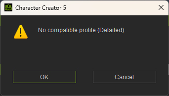

I assume this is supposed to be possible, but I can’t get it to work. Whenever I try to bring in a DAZ model with Transformer I get an error
Is there a workaround? Is this feature real???

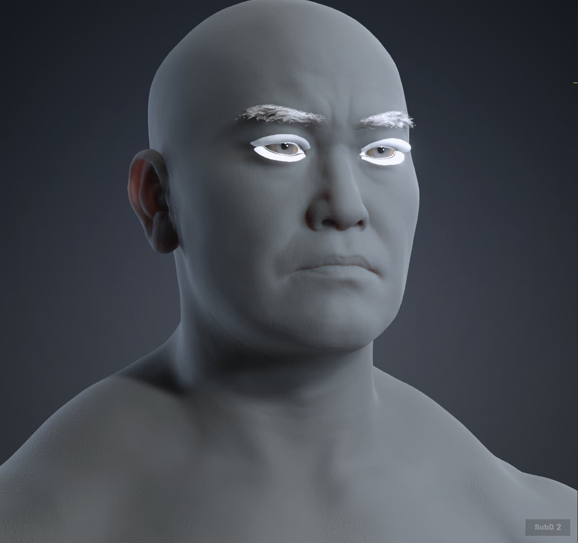

You also have to set the eyelashes Subdivision Level to 2, and if it’s a Genesis 8.1, you have to change the name of the root where it says 8_1. It’s quite a hassle to do — I don’t know why they don’t fix it when importing.
Thanks @DomusLudus! I had to set everything to Subdivision 2 not just the eyelashes, so the eyelashes, tear ducts, eyes, mouth and eyebrows, but once I did that it worked!
