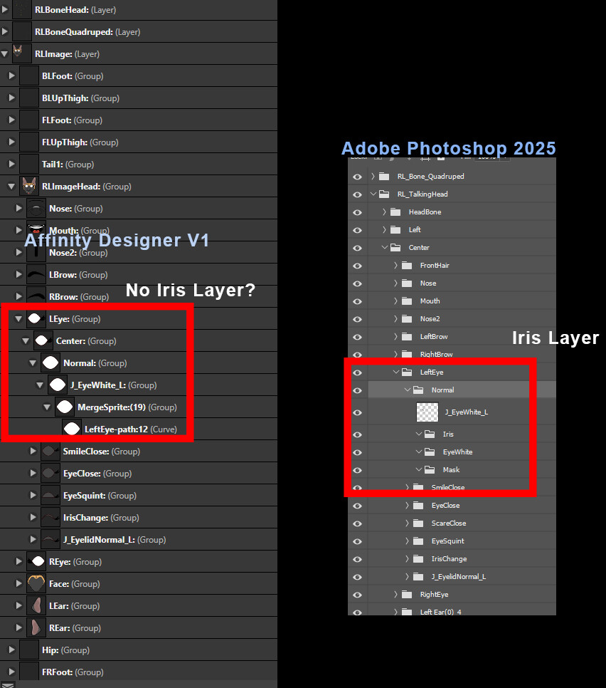

Hi All,
I have scoured the forums and internet but have come back with nothing. I have read thoroughly the documentation and been following Garry Pye’s latest Webinar on setting up a Dog in CTA5 (which is a brilliant tutorial especially for beginners as I am) but I am still scratching my head. I have a photoshop license only so I have a license to Affinity Designer V1 to do any vector work in. I want to keep my character as a Vector however when I send it across to add in the Iris (as per Garry Pye’s webinar) on opening in Affinity Designer there is no Iris option. However when I send it across to Photoshop, which converts it to a bitmap format it indeed has the layer for Iris. I have attached a screen shot showing the layers so people can see what I mean. So my question is do I simply add a layer group and call it: Iris, EyeWhite and Mask in Affinity Designer, place the data into it and on sending back to CTA5 it will pick that up? Any advise would be greatly appreciated. I have included the image screen grabs for your perusal.
Thanking you
Regards
Shez
