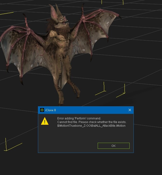

Hello, ive purchased the "73 Animals Pack " a while ago, now i find out the performance links are all invalid (which are hundrets of them). Is there an easy way to correct this ? They all point into the wrong folders. (tested on 2 different Installations on 2 different Workstations with the same result). Unfortunately that pack is not availabla any more so i wont dare to re-install it. Editing the performance List is not an option.

They are currently under animation/motion/ … subfolder for each animal. The expected path would be motion/Truebone_Z-OO/ , some even expect the motions to be on drive D somewhere in a strange path. I thought i could fix that by editing the files that iclone uses to locate them but couldnt find any yet. True, i probably need to create and move them into that path above. Just hope iclone doesnt get mixed up with that because it may point to files that dont exist in their original content manager path/folder.

"The Perform way was an old way to animate props, please try to find the related motion files in the pack directory, " Which makes me wonder if “newer” packs would use the perform list at all. In my eyes the perform list is a great function for individual characters, you dont have to search the content, animations are right there with a right click.
