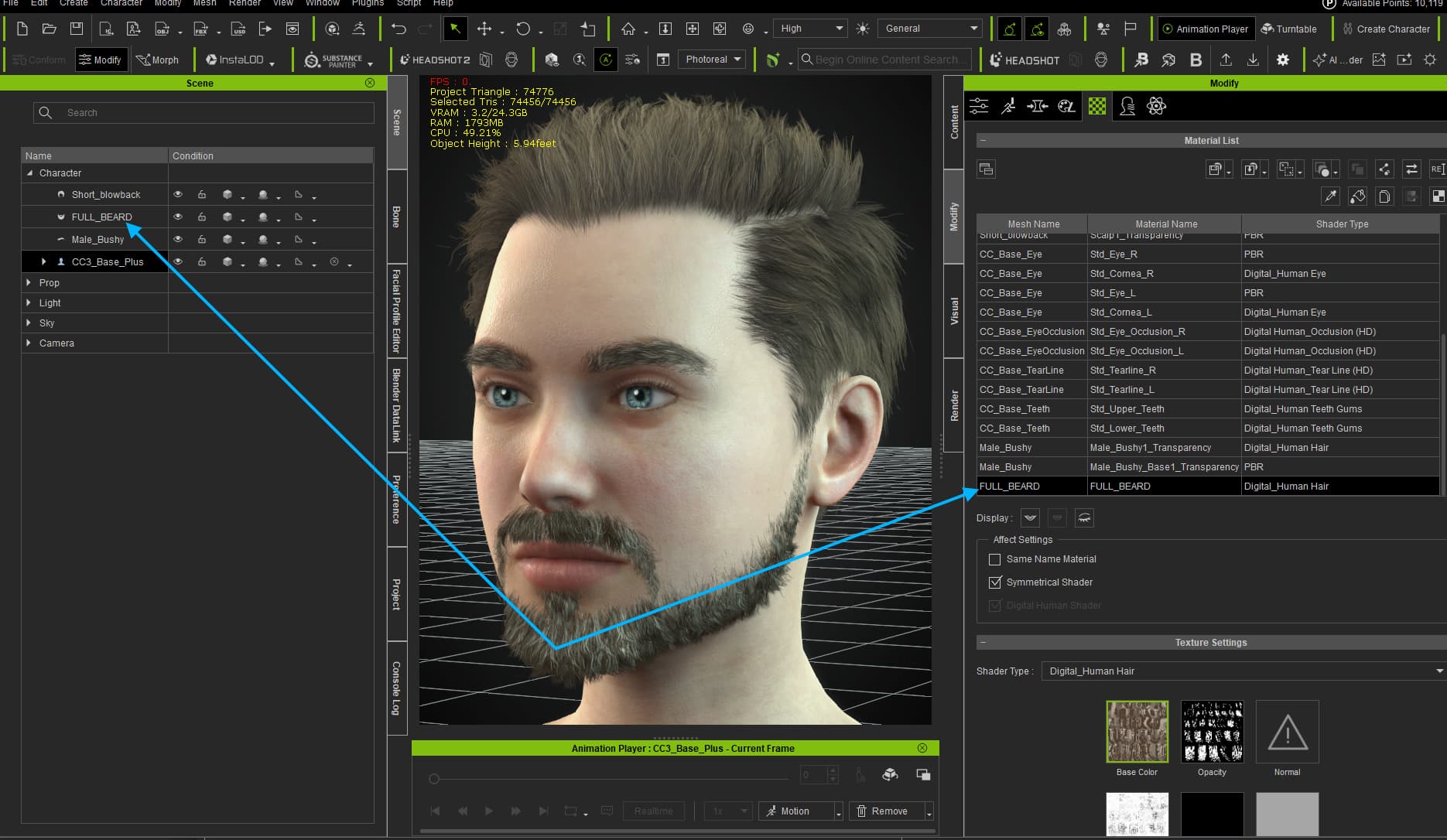

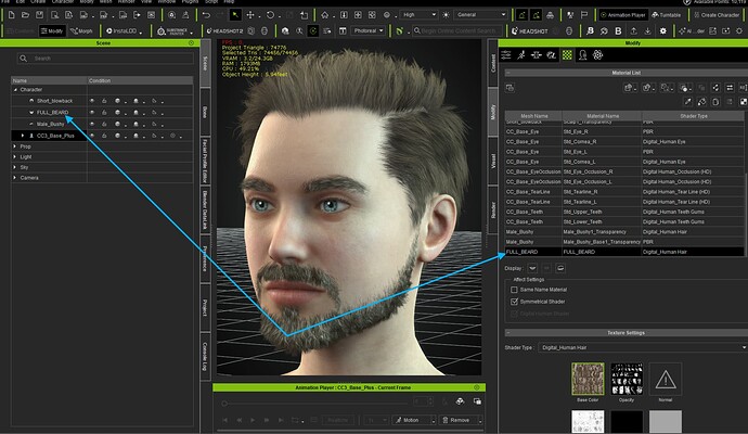

If i drag & drop a beard from the content tab to my character, it is split in 4 sperate meshes, with the same material.
however, to consolidate a material, it seems like it has to be in a single object, wich i think CC4 cannot do? I might be wrong on this, but i have found nothing on merging meshes or objects.
Though I can merge the materials, but it will result in the resolution of the facial hair being divided by 3 unnecessarily.
And during the export, checking the option to merge the facial hair should resolve this issue, but since it is multiple materials, importing the character into Unity will just split the meshes again to assign the right material for each part of the facial hair.

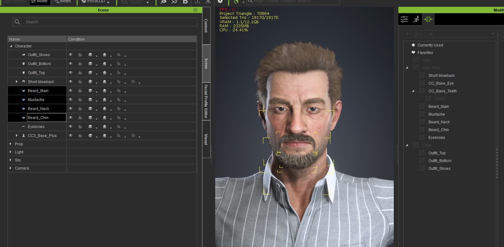

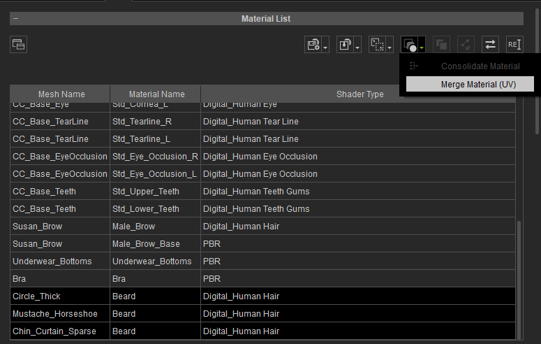

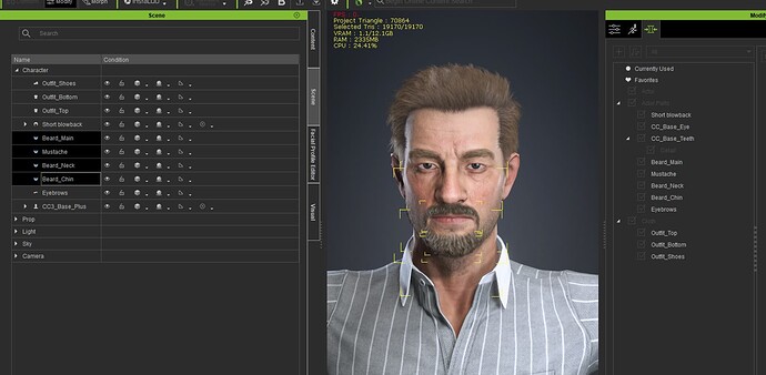

Hi, just checking — does the Merge Material (UV) tool help with your issue?
You can select multiple meshes and combine them into one object, but it will bake all the UVs onto a single texture.
So as you mentioned, because the UVs are baked together, it results in the facial hair resolution being divided by 3. If you need the original-quality objects, then merging is indeed not feasible.
This is currently a limitation of the existing feature. I’ll also pass your use case to the team to see if we can consider related improvements in future development.

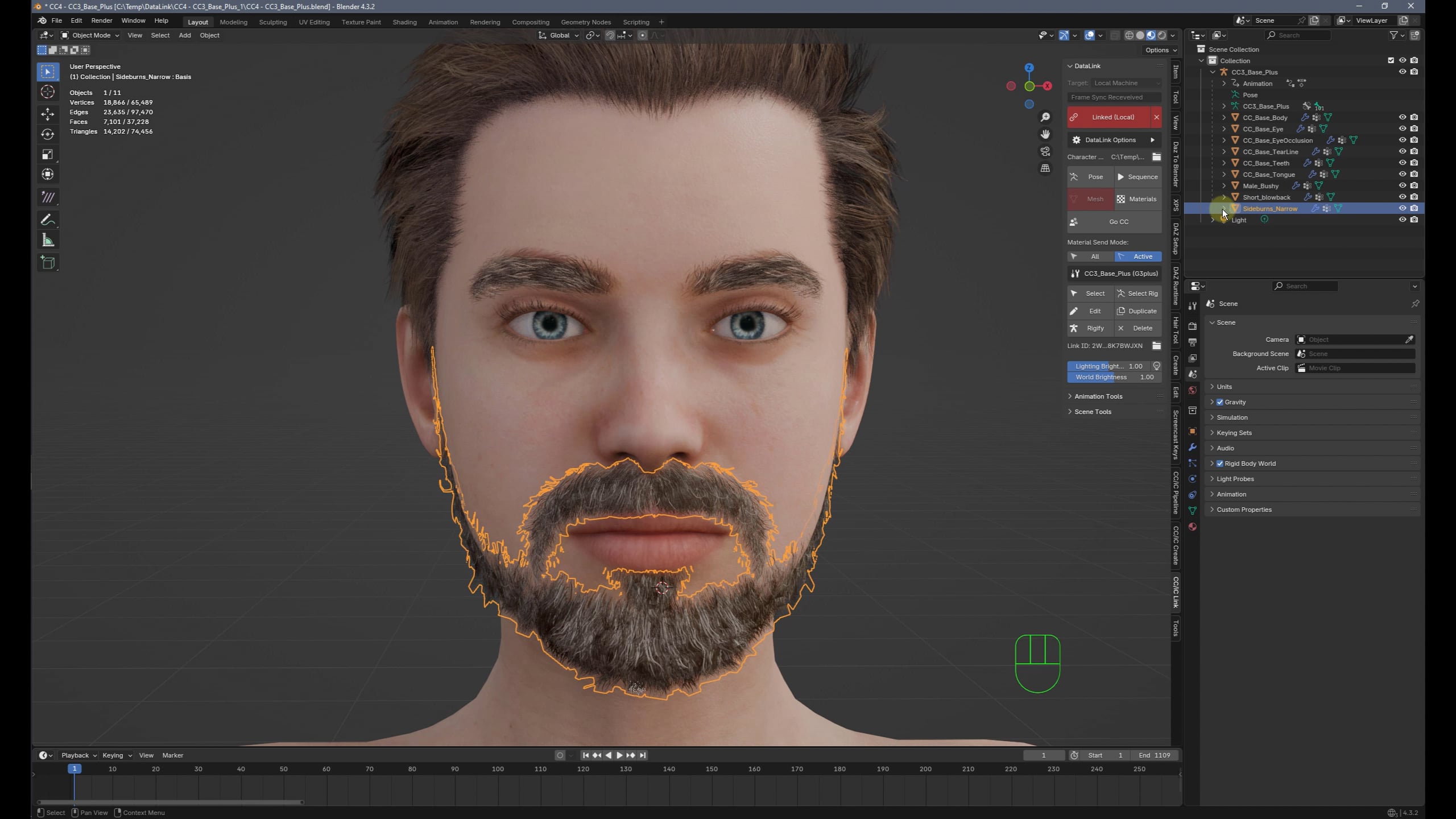

CC does not have a reliable function which will merge separate meshes with identical UVs and materials. While in Blender it takes literally 30 seconds to merge meshes and then consolidate materials preserving original UVs and without loosing texture quality.
We really need that feature. Often times we import assets from other apps where there is a lot of meshes and materials could be consolidated saving tons of resources internally and while exporting.
This was done with Blender pipeline for the 4 beard piece (default Short Boxed hairstyle).
