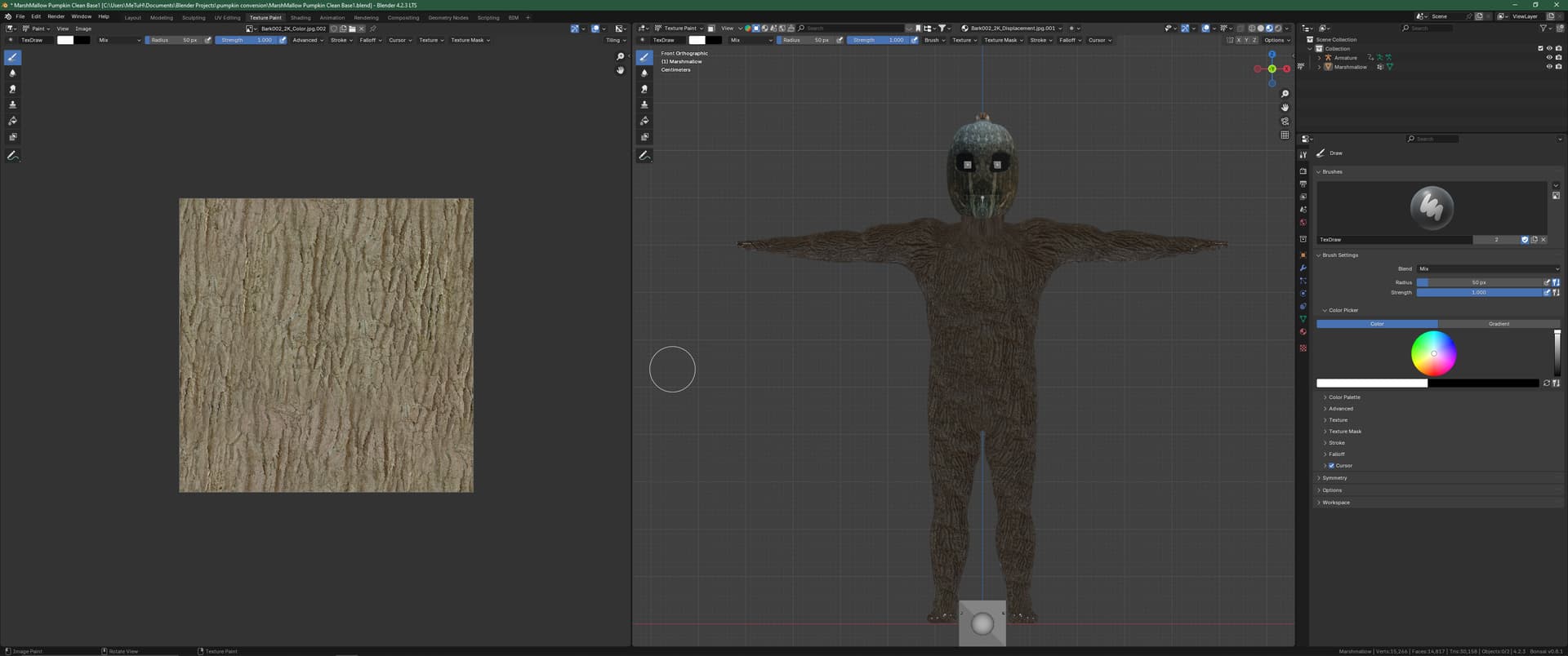

in the first image the head is just a pure 1 slot texture and material photogrammetry pumpkin, while the body is the full color. roughness, slots etc. I have also changed the color in the nodes
What was done to get the pumpkin in blender to be 1 slot and what makes cc4 recognize it automatically for slotting in as opposed to the body?

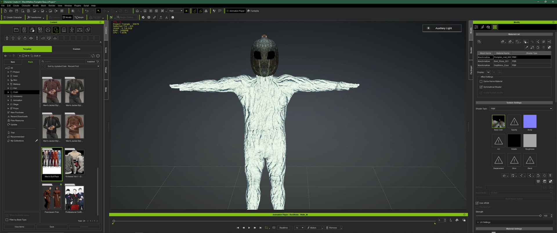

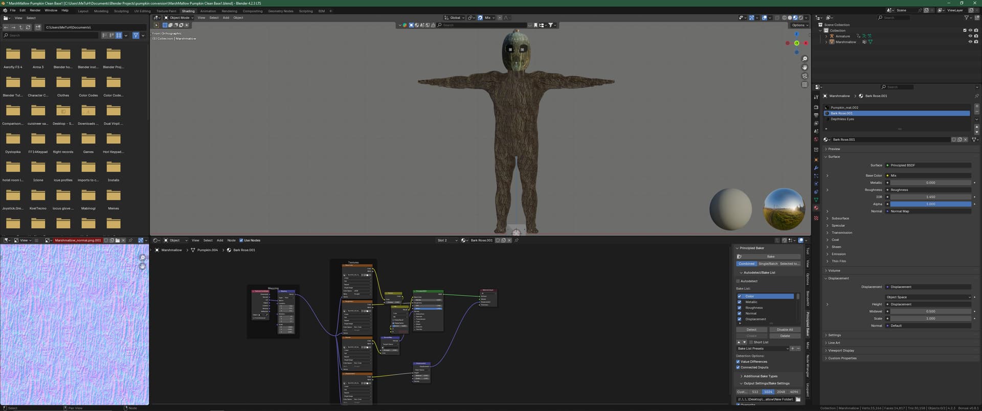

Let me understand. You bake a procedural material into a texture in Blender and export to CC, but baked texture does not look the same after the export? Then it’s a Blender issue, or rather how it bakes complex node based materials sometimes.
But regardless, it happens a lot in my personal experience and I always handle it on CC/IC end.

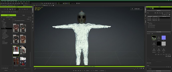

That is checking and assigning a different value to Diffuse Color.

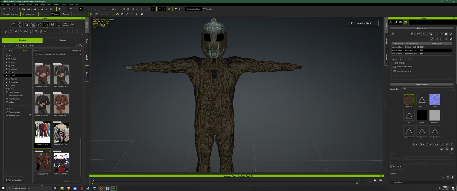

Then there is a lot you can do to change texture appearance by simply using Adjust Color control for specific texture.

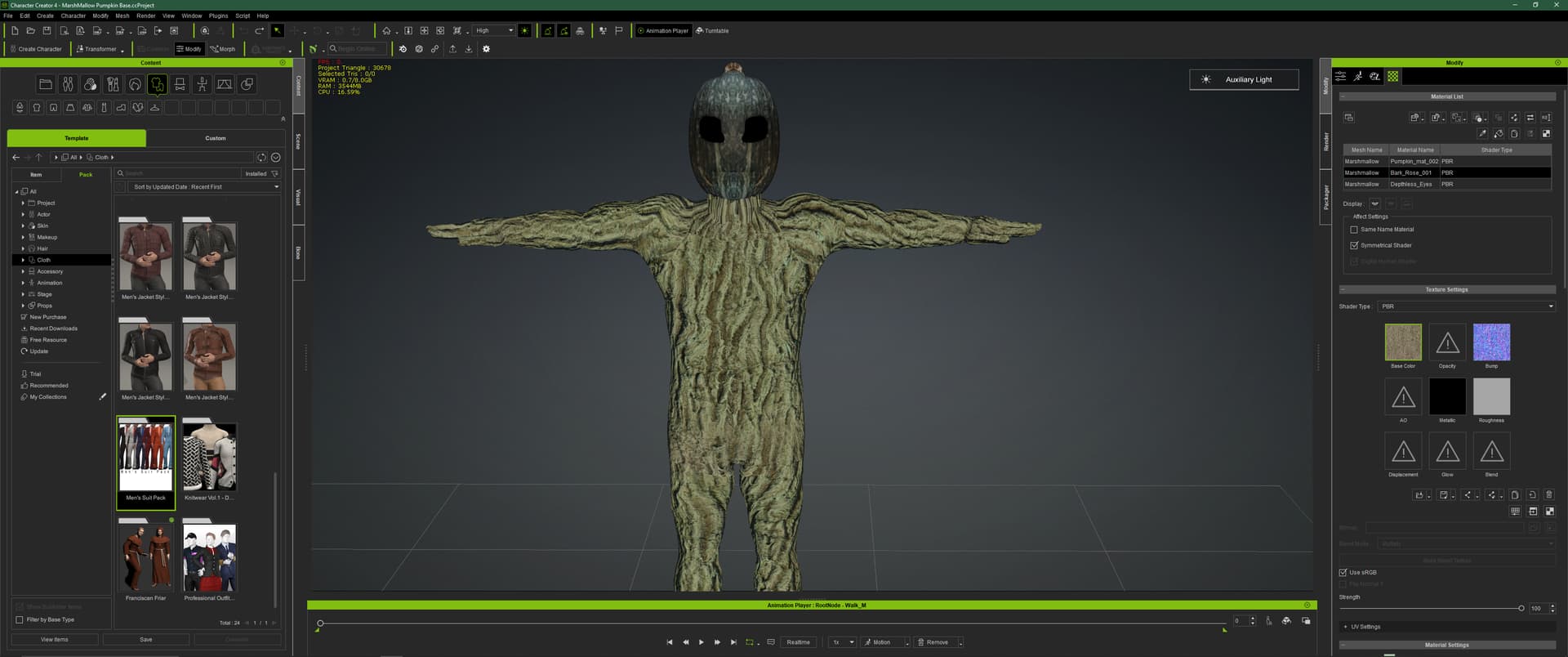

Sometimes I need to tweak texture properties in UV section (tile it, offset, rotate… etc).
Use external editor… etc…
