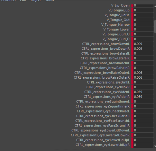

This image below shows your FBX file provided

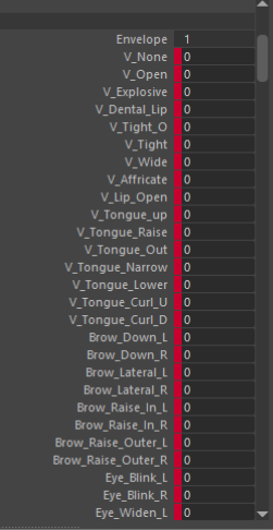

Thus, the image below shows the correct expression naming output when using the UE5 template.

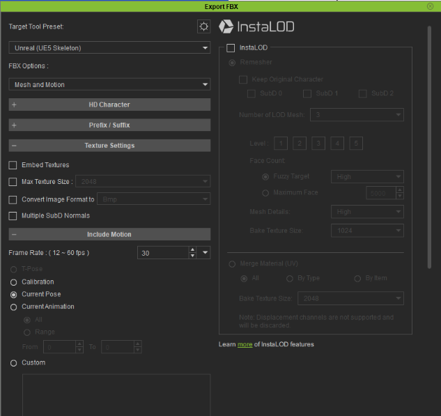

Please select the correct UE5 template from the export settings as shown below
