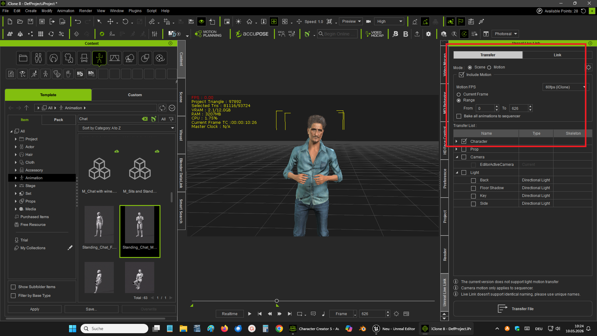

Have you enabled Transfer Scene, including Motion?
And the duration of your animation.
With Live Link, you won’t be prompted to import in HQ; it happens automatically.
