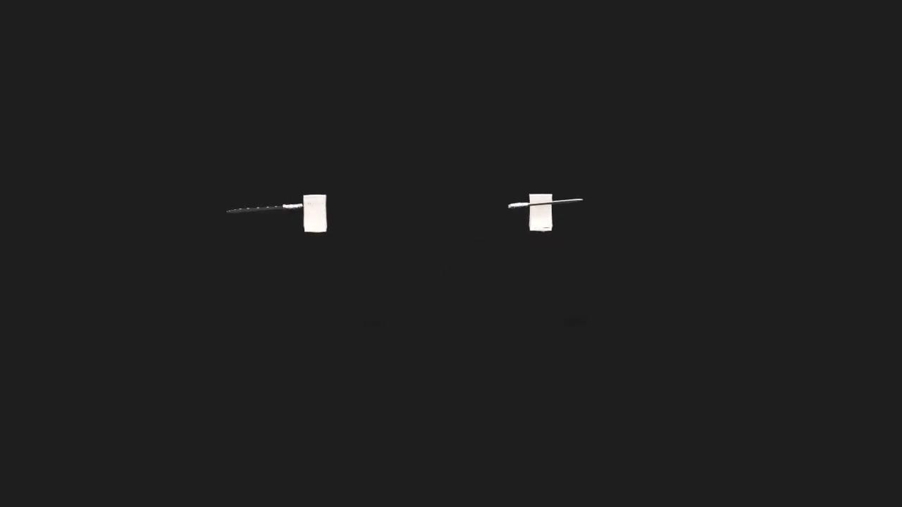

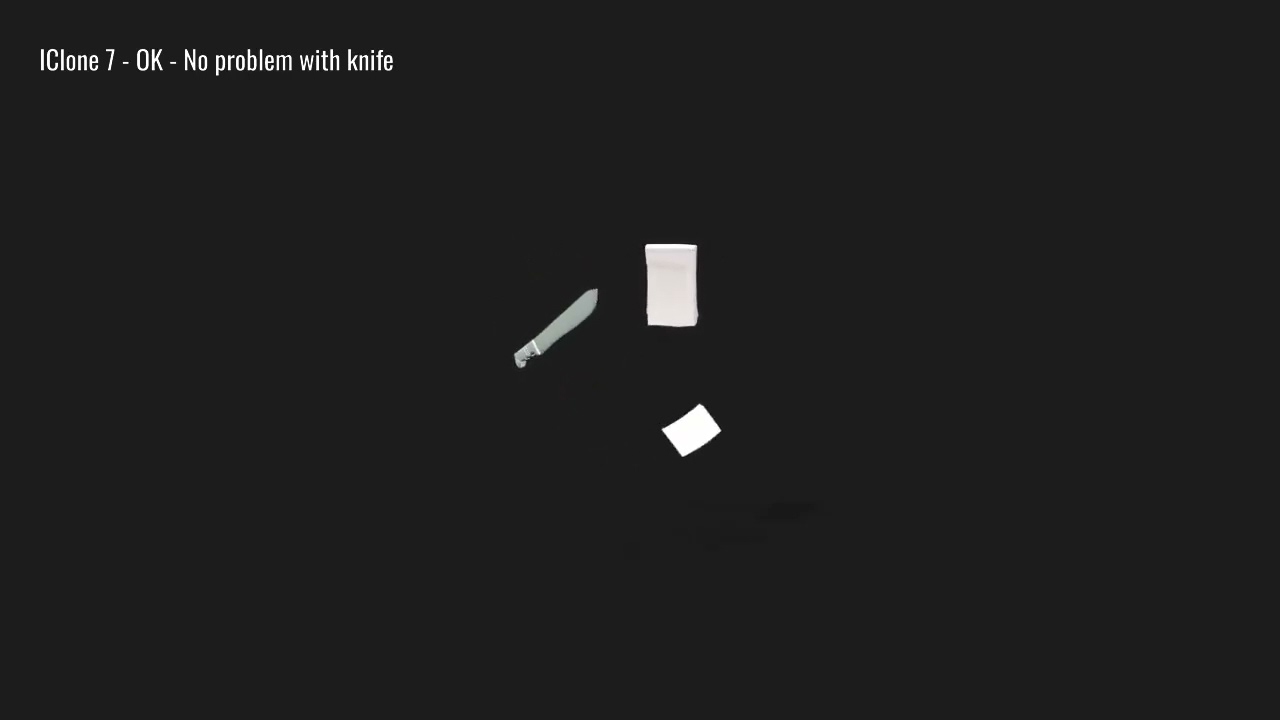

I have an IProp that works well in IC8 but is completely messed up in IC8.
The same happens if I use the FBX in IC7 and IC8. In IC8 it change some animations!!!
The video bellow explains the problem and I also attach here the link to the IProp if someone wants to see it.

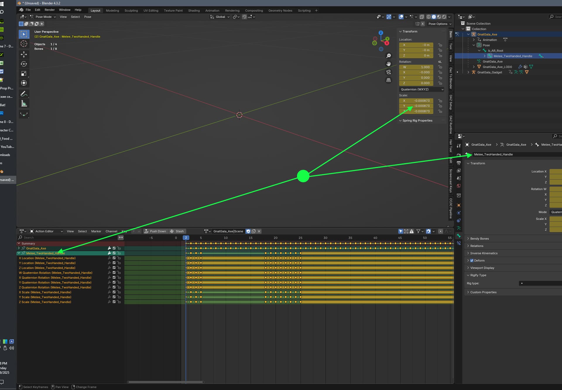

I figured the issue…
IC8 cannot handle animations where bone scale value starts with a negative number (consecutive rotations are getting messed up).
The bone a machete attached to, starts with a negative scale for XYZ and then frame 18 is also negative. It can be a small number but should be positive. Probably a bug in IC8.
Once you fix it in Blender it should work fine in IC8
