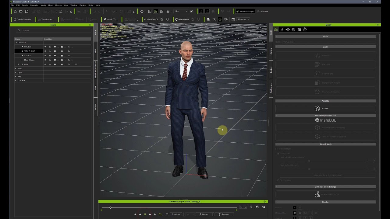

I tried the shirt and tie on a Neutral Male character and I don’t see any distortion in the buttons:

Edit Yub Not distorted. But check next post.
@Nirwana
Are you able to Select the Buttons in Edit Range as an Element?
I was able to Select Them Via Brush and then Weight to 0.
Yes. Did you activate the “Select (Q)” tool?
Yes I did,
The Visual of Selection Button in this and Reallusion Business Shirt Appeared Different , which was basis of confusion for Novice like me.
