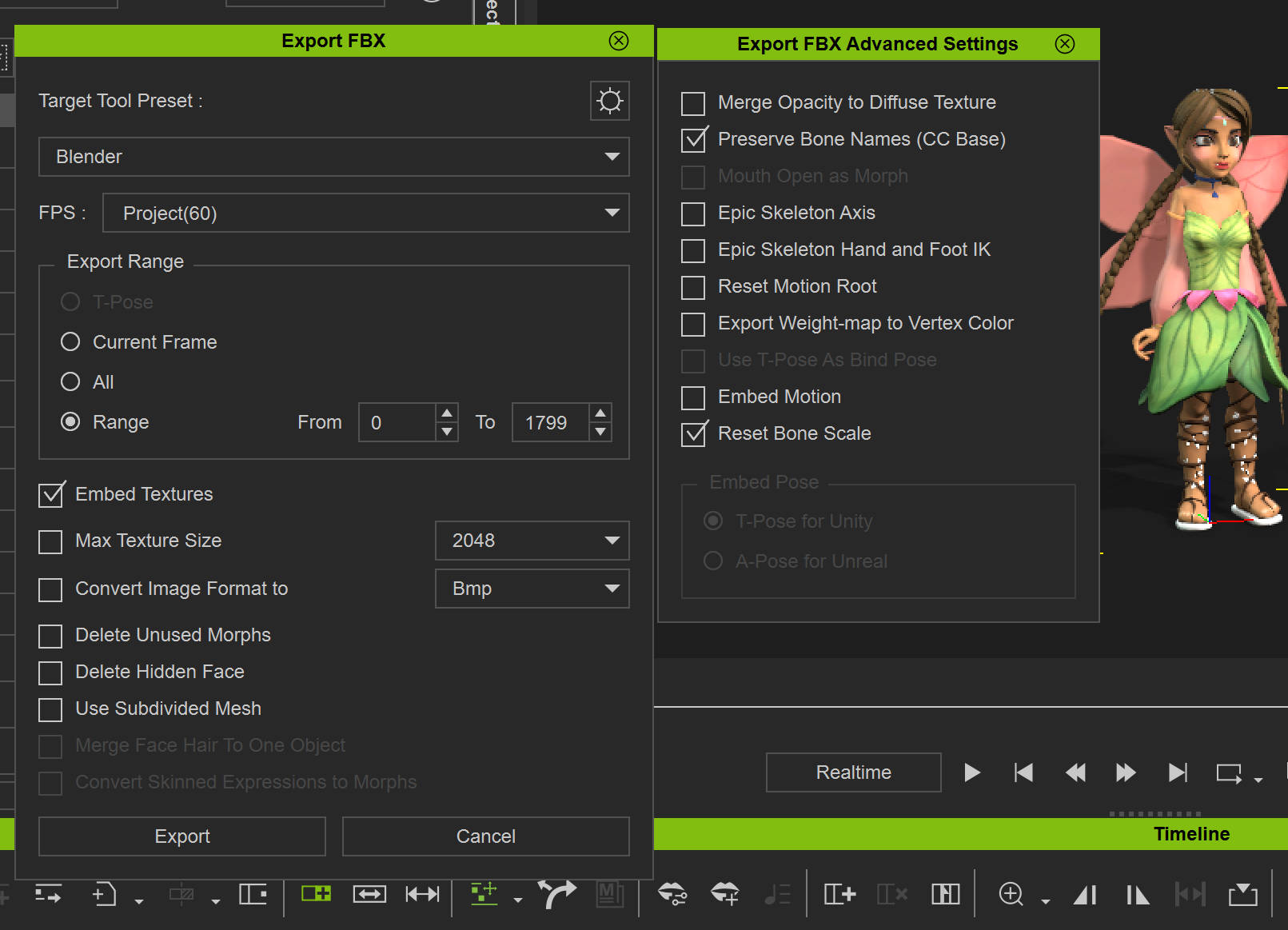

Hi Everyone, i have an issue where i am unable to tick the box ‘Mouth Open as Morph’ when exporting my character from iClone. I suspect the issue might lie in the fact that I have custom facial expressions for my character. My workflow was:
Model character in blender → Bring to CC4 to do Accurig and and check weightpaint → Export out from CC4 with option Mesh and Expression sequence → Bring to blender to do blendshapes and export as fbx → Bring back to CC4 and import with FBX with frame sequence.
The sliders all work fine in CC4, with my Jaw_Open slider working well but once i send to Iclone8 to do my animation, when i want to export it doesnt allow me to export with Mouth Open as Morph option :frowning: Ive tried lookking for some time for any tutorials but to no avail. Is it impossible to do it or is there any alternative way to go aorund this? Any help would be appreciated, thanks !!

I’ve passed this to the dev team to get their feedback on a possible workaround for iClone. Once I have more information I’ll share it here.
Thank you so much !
Hi Pete,
May I know if the dev team have been able to find a workaround? Thanks !
Hi…
Unfortunately the “Open Mouth as Morph” currently only supports standard CC characters. The dev team will look at ways to make this available for non-standard characters as well, but this hasn’t been confirmed as yet.
