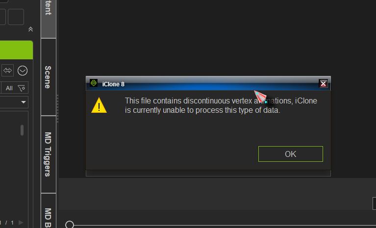

How do I import alembic filkes into iclone 8 I keep getting the same error (I am trying to go from Liquigen (I know its not compatable) then take my alembic file into Blender to export for importing into iclone v8. Is there a Blender setting I am missing when exporting alembic inside blender to covert to alembic for use in iclone v8. are there any tutorials to convert alembic to use in iclone 8? My alembic files work inside blender but after exporting from blender to alembic same error (alembic direct export will not work in iclone but I think blender alembic should work in iclone v8

The only Alembic files that can be imported are those where the number of and the order vertexes does not change. So deformations are OK (as in clothing) but anything else will not work.

any fluid sim that has a “flow” source like liquigen of flip fluids will not have a fixed number of vertices which is why you are getting that error.
Blender or UE for C4D etc are “streaming” fluids from an imported alembic cache file and the vertex number is changing with each frame.
you might be able to import a wavy ocean plane from blender into iclone as alembic because it is just a flat plane with animated displacements via the ocean modifier.
But no “flow based” fluids are possible.
