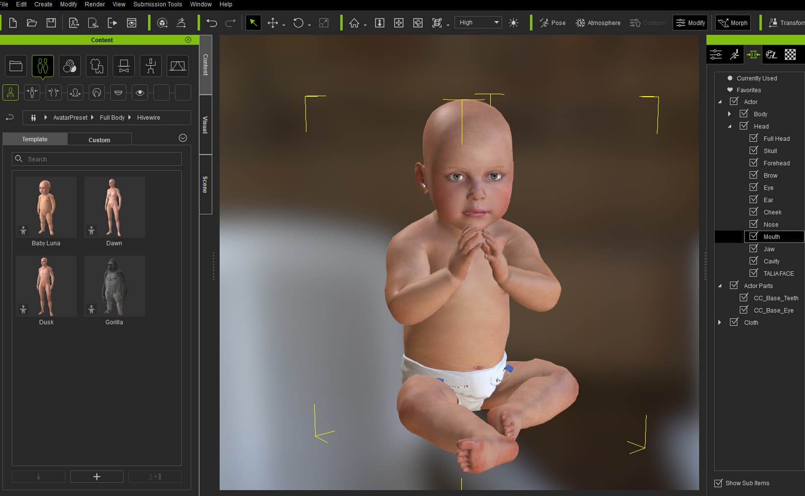

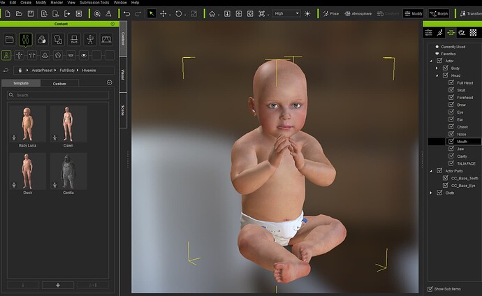

CC3’s default content included the figure “baby Luna” from
the former Hivewire community.

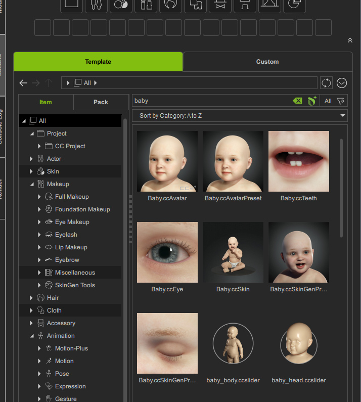

I can’t find those. Is there a pack I need to install?
I did figure out the Human Anatomy Baby, but it wouldn’t let me use ‘Edit Motion Layer’

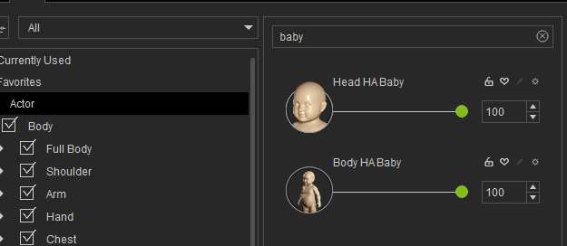

You said you have that pack (Ultimate Morphs - the one @thebiz.movies referenced). It’s part of that pack. Just search for baby in Sliders
Untitled-2
Or if you also have a Human Anatomy pack you may get a ready to go baby avatar with respective skin presets

I have the Human Anatomy. I found the baby. It’s a little bigger than I envisioned, but this will work.
Thanks
