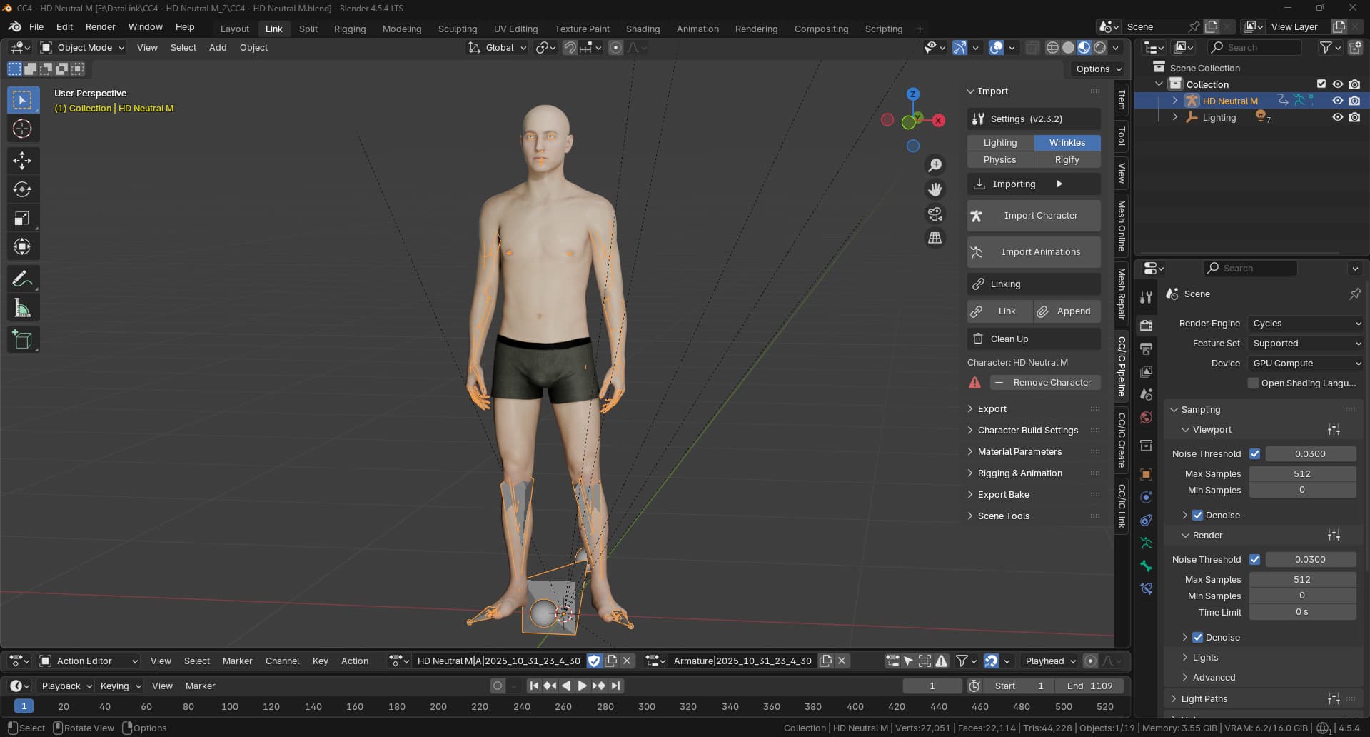

For reference: This is what it should look like after a successful import
(Pipeline version 2.3.2 on Blender 4.5.4)

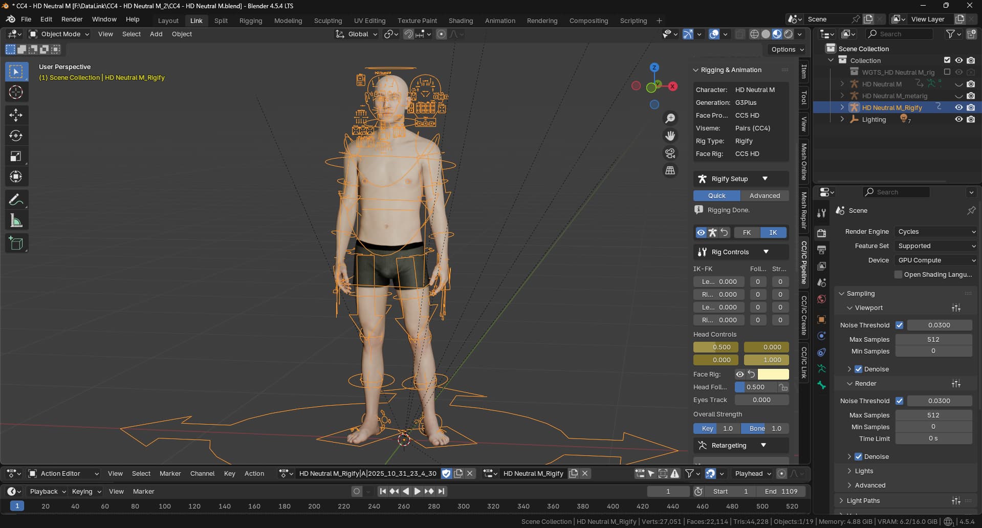

And after a successful Rigify, there should be three rigs (The original, the metarig and the rigify rig):
