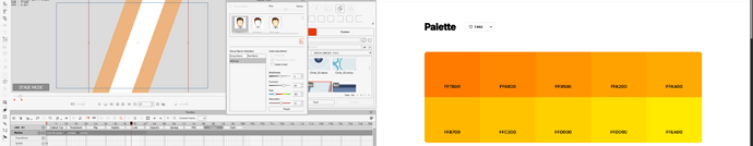

I’m working on an animated transition in CTA5 and I’m struggling with color adjustments. I have a specific color palette I need to use, outlined in the image below (you can see the palette on the right side).
I’m familiar with the Render Style options for adjusting colors (Brightness, Contrast, Hue, Saturation), and I can tweak the group colors using those sliders. However, my desired palette is in hex-code values, and I can’t find a way to directly input hex codes into Cartoon Animator 5.

Hi…
Render Styles was originally introduced in CTA 2. In CTA 5 we now use SVG Color Adjustment for setting precise color input.
Please take a look at the tutorial HERE. This explains how to use the SVG Color Adjustment feature.
