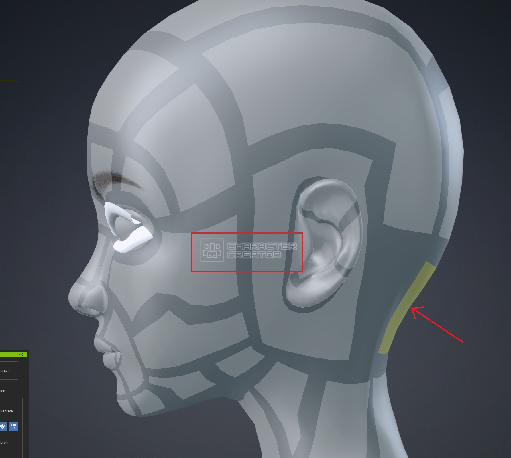

I have purchased Headshot3.
When I move the target at the base of the neck from the side using the
a watermark appears on the screen.
When this happens, I can’t send the file to Blender using Blender Data Link.
Similarly, moving the eyebrows also causes a watermark.
I haven’t checked everything, so there might be other issues.

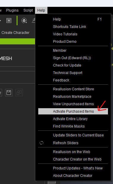

Hello,
I am not sure whether this is due to the content installation account being different from your current program account.
Please try clicking the Menu > Activate Purchased Items to see if it works.
If the issue persists, please contact Reallusion Support for further assistance.

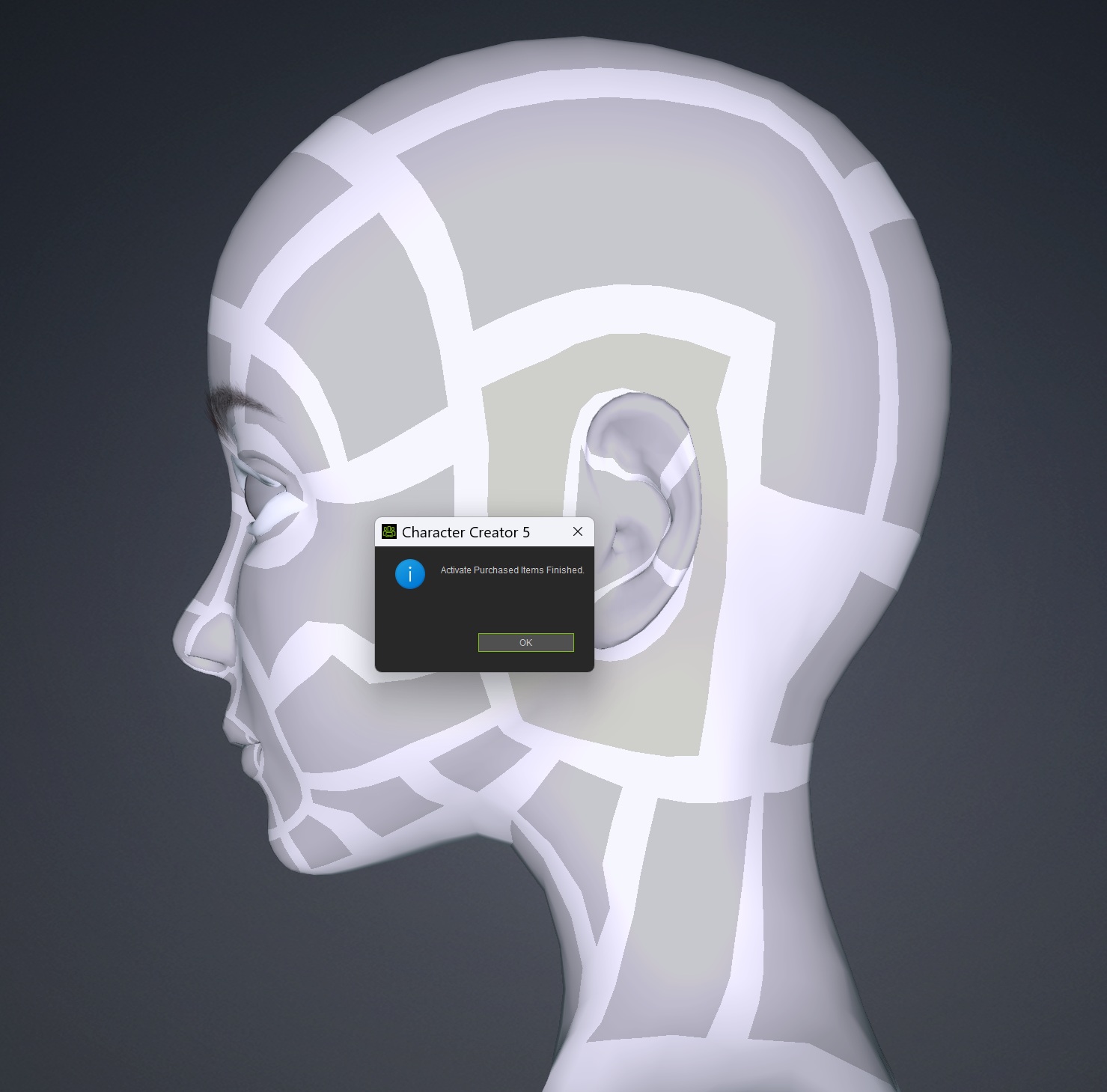

After running “Activate Purchased Items” from the Help menu,
the software updated for a while,
and then it displayed “Activate Purchased Items Finished.”
The watermark has disappeared since then.
I think it’s fixed. Thank you.
