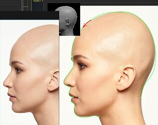

Headshot 3 Side view Refine Problem
Why does this tool work like this?

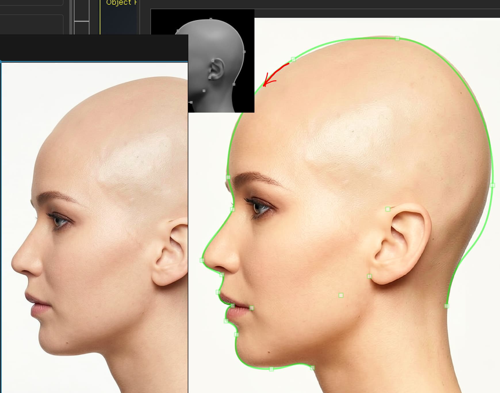

@runmax4 Yeah, we already had some discussion about this problem. The side view refinement requires very specific placements of the curve nodes. If you don’t adhere to that, the head gets deformed.
Try moving the forehead node down. Reallusion recommends to place this node where the hairline would be located (see the red arrow).

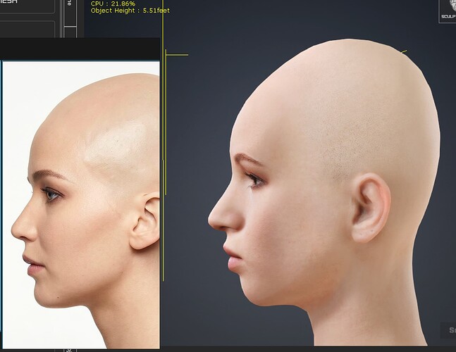

Thanks, but the issue is not just the hairline — the side view refined curve isn’t working.
@runmax4 You also need to experiment with the placement of the other nodes. It’s not a 1:1 transformation from the side view curve onto the 3d head model.
