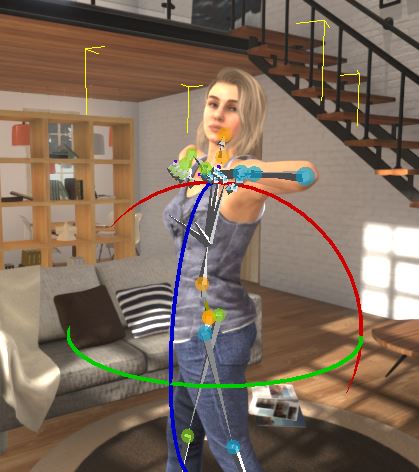

Hi everyone,
I’m trying to rotate my avatar’s torso in iClone, but the head stays static instead of moving along with it. I want the head to automatically follow the torso’s rotation.
Does anyone know how to fix this? I’ve attached a picture
Head problem
for reference.
Thanks in advance!
Shirley
Check that the character “lookat” is not active. She may be looking at the camera.
Thank you, thebiz.movies,
That makes total sense! If the head is assigned to look at the camera, of course, it will stay fixed on it. Now that you mention it, I remember coming across and enabling that option.
I found it, disabled it, and that did the trick!
Thank you so much for pointing me in the right direction. On to the next challenge, haha! :smile:
