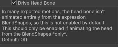

There is this script called Bone Driver on the characters. I turned Drive Head on.

unity CC/iC importer settings (are they reapplied everytime you hit build character tho? or I have to do something else?) :
